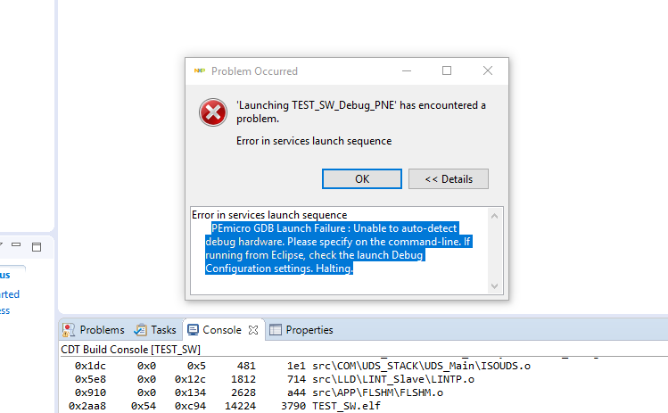

snehal_pawar
hello
i have face an error at time of debugging like
can anyone please give me solution to resolve this error
6 Replies
4,484 Views
jiri_kral
Just to be sure that it is S32DS issue - Are you able see your Cyclone probe in PE Micro tools? For example in progacmp_cyclone.exe app:
One stupid question - your previous debug session is already closed, correct?

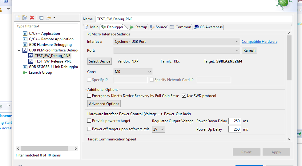

what's your s32ds version and MCU? Can you please share your debug session settings screen?
Jiri
4,484 Views
snehal_pawar
my s32 version is Version: 2018.R1 (for ARM)
4,484 Views
jiri_kral
what about cyclone driver? It is correctly installed and you can see Debugger in Windows Device Manager?
Jiri
4,484 Views
snehal_pawar
Yes
