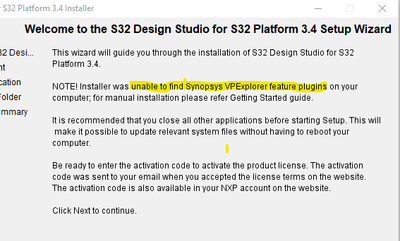

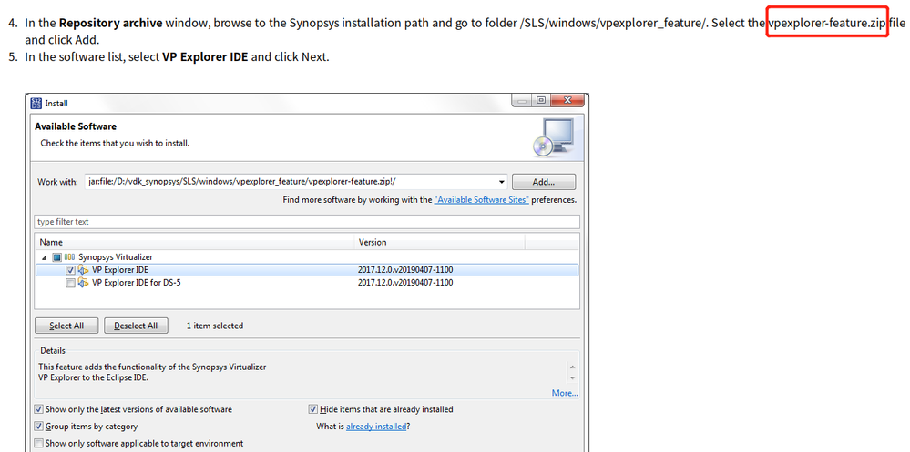

In "S32 Design Studio for S32 Platform 3.5 Installation Guide",have mentioned :"vpexplorer-feature.zip" file. bug i can't find the file.
while can download the file?

saginala_khaderbasha
when I am going next ignoring note as shown in pic above its showing "You don't have enough permissions"
can anyone tell where to download Synopsys VP explorer feature plugin
3,966 Views
mikedoidge
The installation of S32 Design Studio requires that the user's account on Windows is a member of the administrator's group. If your account does not meet this requirement, then perhaps you can use the Run as Administrator option. Another possibility, you could try to enable Windows 7 compatibility mode. Or contact your IT department for assistance.
Installing the Synopsis VDK eclipse plug-in isn't required to use S32DS. In general, this is used for development work which occurs prior to the availability of actual hardware (NXP devices, evaluation boards, etc.). I ask you again, do you know that you need this plug-in, or are you only requesting it because of the note displayed in the installer?

mikedoidge
Hello @jone_yang,
You can get the Virtualizer Development Kit here: https://www.nxp.com/webapp/connect/displayPartnerProfile.sp?partnerId=15200&offeringId=25420
