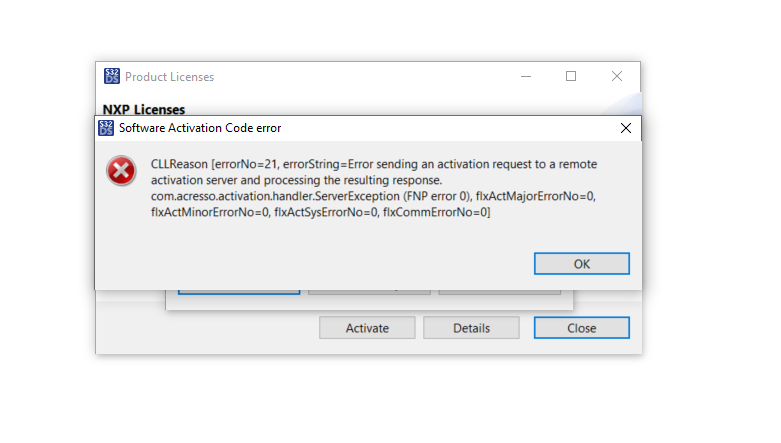

I was using S32DS Version 3.4 and suddenly it was stopped working and a pop up message came up for "Missing License".
I have license activation key and I used it for online as well as offline activation but following error message is coming :
CLLReason [errorNo=21,errorString= Error sending an activation request to remote activation server and processing the resulting respone.........]. Please see attachment.
Can you please help me with this.

Hi, Ajay,
As I talked with you, it has found that it was firewall setting which was blocking the server request for the license activation.
Happy that you were able to resolve the issue and move forward.

Hello Mehul,
Yes, It worked with this solution. Thank you
