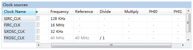

I am using a 16M external crystal,I want to configure the CLOCK module,  but I can not modify the CLK value in the PE tool.Is not 5748g external crystal can not be connected to 16M ?
1,514 Views
martin_kovar
it looks like a bug, because XOSC can be in range 8-40MHz according to reference manual. I created bug ticket to development team.
