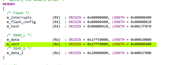

How does one go about specifying a specific address for a variable (in my case pointer table)?
I can get the pointer table to be placed at the specific RAM address, but it is not initialized with the correct data (or any data?).
I start by adding a section in MEMORY
MEMORY
  FLASH_1      (RX)  : ORIGIN = 0x00000000LENGTH = 0x00000400
  FLASH_CONFIG (RX)  : ORIGIN = 0x00000400LENGTH = 0x00000010
  FLASH_2      (RX)  : ORIGIN = 0x00000410LENGTH = 0x0001BBF0
  CAL_FLASH    (RX)  : ORIGIN = 0x0001C000LENGTH = 0x00020000
  PTR_TABLE    (RW)  : ORIGIN = 0x1FFFF000LENGTH = 0x00000200
  SRAM         (RW)  : ORIGIN = 0x1FFFF200LENGTH = 0x00003E00
Then, I reserve the memory:
.ptrTable :  AT(__DATA_ROM)
    . = ALIGN(4);
    _ptrTableSection = ./* create a global symbol at PtrTable */
    *(.ptrTable)
    . = ALIGN(4);
  } > PTR_TABLE
Finally, the romp:
.romp : AT(_romp_at)
  __S_romp = _romp_at;
    LONG(__DATA_ROM);
    LONG(_ptrTableSection);
    LONG(SIZEOF(.ptrTable));
    LONG(__DATA_ROM + SIZEOF(.ptrTable));
    LONG(_sdata);
    LONG(___data_size);
    LONG(0);
    LONG(0);
    LONG(0);
  } > SRAM
For now, my work around is to define the pointer table as ROM data then copy this over at runtime manually to the RAM pointer table. There must be a better way of doing this. What am I doing wrong here?

I'm afraid that you will need some routine for copying data from Flash vector table into RAM. Technically it is the very same process as initialized variables.
The easiest way is left existing startup code and  move your RAM vector table into your section:
Startup will copy data from Flash into RAM and setup VTOR register.

Thanks for your help Jiri. Much appreciated.
