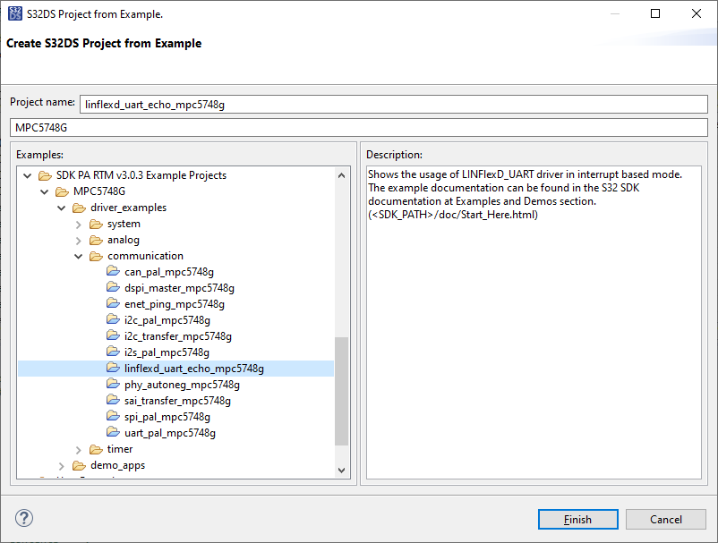

The SDK PA RTM v3.0.3 includes the drivers and an example project for LIN.
File -> New -> S32DS Project from Example:

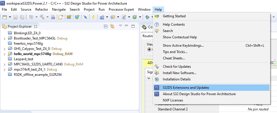

To install the SDK:
Help -> S32DS Extensions and Updates
Search on 's32 sdk 3.0.3'
Check the box and click 'Install/Update'

thank you for your response. Unfortunately, we are unable to locate the LIN example in the S32 Studio for PowerPC (version 2.1 build 190624) and PA SDK RTM 3.0.3 (exact version 1.0.0.202008261642) installed (all updates are installed, to the best of our knowledge the versions are the latest officially released by NXP). We can locate the UART examples for the LINFlex controller, but not a dedicated LIN example for the LINFlex controller. If you can confirm that dedicated examples for LIN do not exists in this SDK package, this would also be a valuable statement to us.
