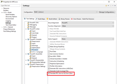

Using Codeworrier -> When typing in assembler instructions codeworrier hardly recognises any of the assembler instructions. It does accept a few like add r3,r4,r5 but won't accept addi r3,r4,50. It won't accept  stw r5,0(r3) so I can't even store data anywhere, and load instructions don't work either. I can say that codeworrier does download my code to my standalone via the JTAG interface so I know that my standalone board is fine. Can someone help with codeworrier recognising the PowerPC assembler instructions.

Regarding CodeWarrior - Seems you are using 32bit BOOKE instruction set instead of VLE. One reason why CodeWarrior may not recognize the instructions is that it is switched to accept VLE instructions only.
Please check if the option below is enabled for your CodeWarrior project:

Hi Stan, thank you for the info. I could not find the Tool Settings in Codeworrier, You must have a different version than I. Anyway I found when you create a new project it gives you the option to use VLE in a checkbox and its ON at default, so I created a new project and unchecked the VLE box and now its accepting all the PPC assembler instruction. A BIG THANK YOU for that. Codeworrier is not a FULL FREE IDE so I would rather use SD32. Codeworrier only allows 64k of code which is useless with our project. Our microcontroller has 2MB of flash and we will need almost ALL of that.
