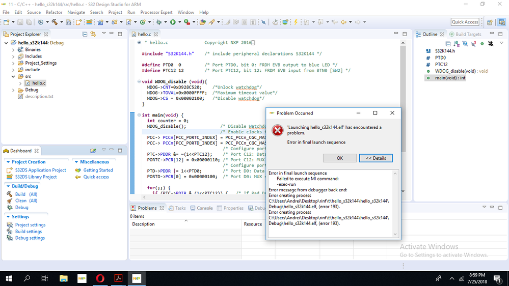

I am trying to run a Hello World program on a S32K144 micro and after i built the program,when i run it i get this error "Launching hello_s32k144.elf has encountered a problem.Error starting process"

I tried to install another compiler and to change the path to it ,but it didn't work

this error looks more related to debugger than compiler. Can you share more details - like output from debug console? Do you have custom board or NXP EVB? If you have custom board - what is your debug probe?

I have the EVB.I am basically trying to light a rgb on my board with an example source code.After i debug i get this pastedImage_1.png

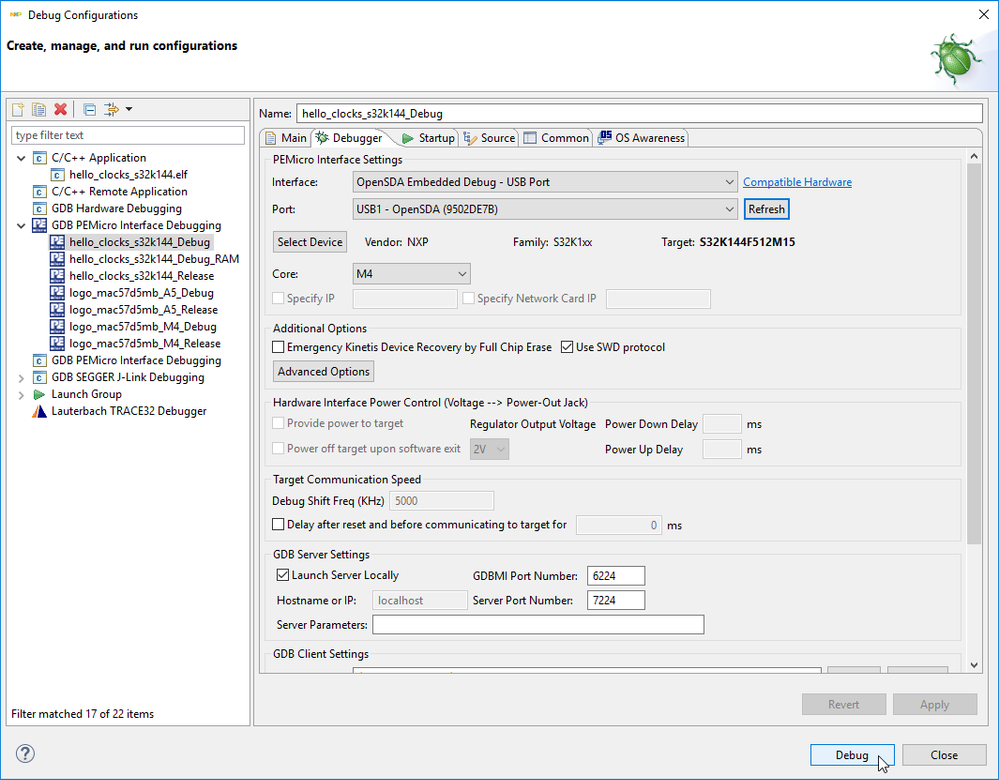

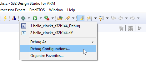

Did you modify the project (or debug session settings) or it is fresh unmodified example? Did you use these steps - build project, open debug configuration
choose your debug config and click on Debug:
