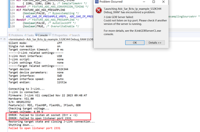

Hi NXP experts,

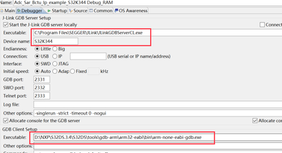

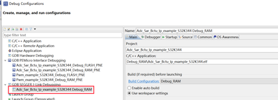

I follow the S32 Design Studio for S32 Platform V3.4/V3.5 + SEG... - NXP Community to using Jlink to connect S32K324(since there is no S32K324 example found in RTD, I use the S32K344 example instead) but meet issue.
My steps shown as follow:
1.
2.
3.
4.
Any steps I miss?
Thanks in advance!
Gavin

I've fixed the issue by removing the step-3 above.
As you can see the error report in step-4 "another server is running...". Since we have set the Jlink serverCL.exe in the setp-2 and the server will be started when do the debug, so the Step-3 should not be done.

did you check with Windows Task Manager if there is really not running another J-Link gdb server instance ?
Other possibility is that Firewall/network policy or other application is blocking port 2331.
