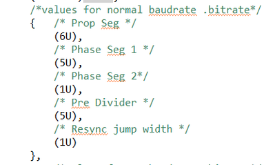

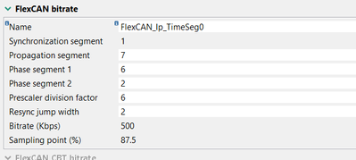

I've entered the following values for FlexCAN bitrate configuration and updated the code.
But the code does not get updated. Old config values are still there in the FlexCAN_Config0 structure variable. But other parameter values are gets updated.
I'm using RTD V3.0.0
Please check and update.

Hi @Riyasma07
Please check the following post. Here, I am helping another customer with the same situation.

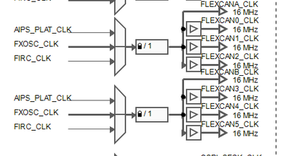

In Example code clock configuration have the below options are enabled.
If i enabled these options means whether it occur  hard fault error or get stuck in below condition.

Hi @LavanyaR
The function Clock_Ip_GetClockFrequency returns the frequency of a given clock, in this case, FXOSC. Make sure that the clock configuration on Config Tools has the same value as your external clock/oscillator.

Hi @VaneB
In FXOSC and CAN0 to CAN5 having the same frequency. I have configures as 16MHz.
