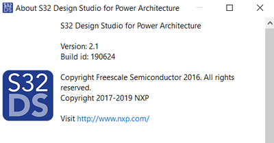

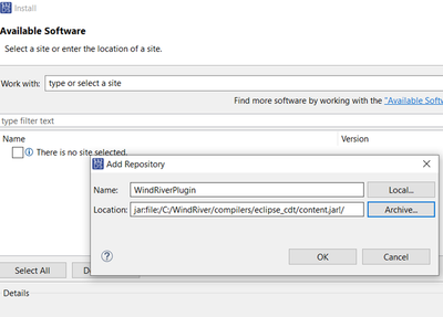

I am new to S32 DS and diab compiler. I am trying to add diab compiler as per instruction on following page.
https://community.nxp.com/t5/S32-Design-Studio-Knowledge-Base/HOWTO-Install-Wind-River-compiler-Ecli...
I am using Install new Software from Help Menu.

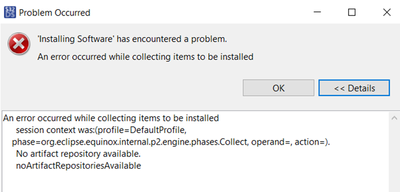

After agree with Term and condition, I am getting following error
I tried google search and re try with disabling available software sites from Preference . But still run in to similar issue.
Please help me to resolve this issue.
S32 Version
dcc command from command line shows correct response. So diab compiler does not have issue.

Have you tried to contact WindRiver support? This plug-in is provided by WindRiver and is likely compatible with certain versions of Eclipse. This guide was developed with the version of S32 Design Studio for Power Architecture v1.1. You are using it with version 2.1. There was an upgrade of the Eclipse version in S32 Design Studio for Power Architecture v2.0 so perhaps there is a different plugin you need to use from WindRiver?
