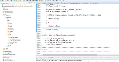

hi,
I can find the “rtc_api_driver.c” in the "S32 Design Studio for Power Architecture ",but can't find the file in the path of the project(workspaceS32DS.Power.2017.R\Uss_multicore\Uss_multicore_z4_0\SDK\platform\drivers\src\rtc_api),and there is a "?" on the floder in the "S32 Design Studio“
How to import these files into the path of the project?

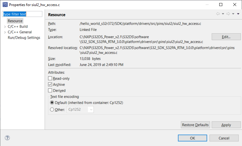

Hello Jun,
If you right-click on the filename in the Project Explorer window, you can select 'Properties' from the menu and see the details of the file. Probably this file is linked into the project from the SDK installation folder. The path to the actual file will be displayed in the properties menu.

gj3526
Hi Mike:
Thanks for your help.
     Yes ,you are right, but I hope it can automatically copy these linked files to my current project.
