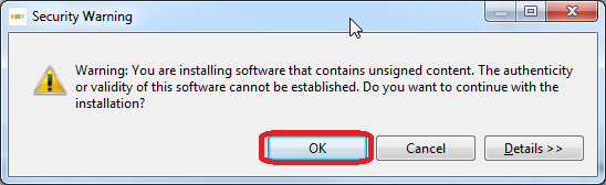

3. Read and Tick " I Accept the terms of the license agreement" and agree with installation of the unsigned content.

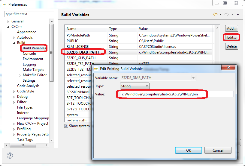

5. Set the path to the Diab compiler for your workspace (S32DS_DIAB_PATH environment variable) in the Window->Preferences->C/C++->Build->Build Variables (Show System Variables). If you switch the workspace you will need to enter this path again.

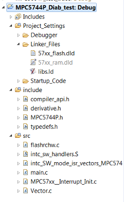

Now you should be able to create a new project with Wind River Diab toolchain available:

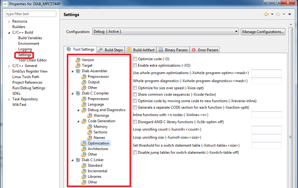

The created project includes Diab specific files such as "dld", startup code as well as tools specific setup in the project properties (Project Properties->C/C++ Build->Settings (Tools Settings Tab)
