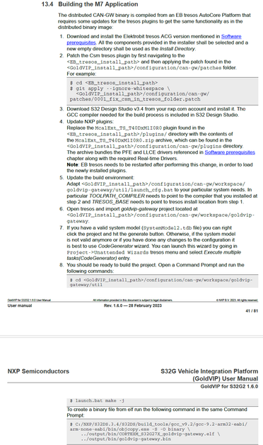

I referred to the User Manual.pdf file of GoldVIP-S32G2 v1.6.0 and proceeded as follows.
1. I installed Goldvip- S32G2 v1.6.0 and EBTresos ACG8.8.7, S32DS 3.4.
2. Follow the steps in Figure 13.4 Building the M7 Application below.
  2-1. Generated the default configuration information using EBTresos.
  2-2. I built using Util of GoldVIP-S32G2-v1.6.0 and created an Elf file.
  2-3. create goldvip-gateway.bin file using objcopy in S32DS Build_tools folder.
3. create an SDcard using fsl-image-goldvip-s32g274ardb2.sdcard and replace only the goldvip-gateway.bin file in the SDcard to write to the board.

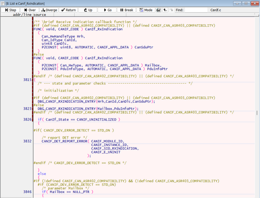

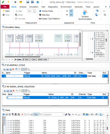

5. The problem was that even though I sent LLCE_CAN0 and LLCE_CAN1 using CANoe, CAN Interrupt did not work, so I could not check the can data coming in.
I used GoldVIP-S32G2-v1.0.0 two years ago and experienced that the CanIf_RxIndication function shown in the screen below is called when CANoe successfully sends CAN data in the same way as above.
Currently, I confirmed that the CanIf_RxIndication function is not called in the same way, and after debugging, I realized that receiving CAN data does not cause an interrupt.

After writing, a CAN data is sent via CANoe, but CANoe shows that the transmission was successful, but no RX interrupt occurs in Trace32.

I'm resolved.
When I disable CanMultiplexedTransmission and change both Filter and Mask to 0, I get an interrupt.
It looks like filter and mask were preventing the data from coming in.
