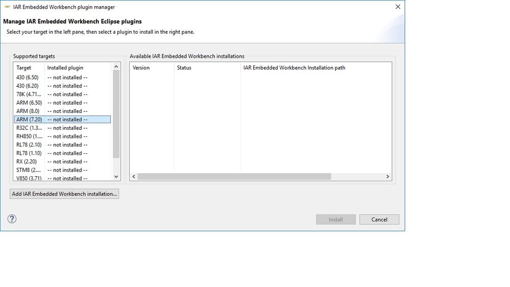

I can't install the IAR plugin in the S32DS.
I use the S32Ds V 1.3.

koehlerl
my problem is, that I can’t Install the plugin because “Incompatible Elicpse Version”.
I have SDS32 V1.3 and IAR EWB 8.11. See screenshot.
Regards Lutz

jiri_kral
I'm afraid that S32DS for ARM (based on Eclipse 4.4.2 Luna)  is supporting only IAR EWB 7.2
6,250 Views
antjerohner
Correct..
.. the S32 Design Studio IDE is based on Eclipse Luna 4.4:
http://www.nxp.com/products/automotive-products/microcontrollers-and-processors/arm-mcus-and-mpus/ea...
The Eclipse Plugin of version 8.xx of the EWARM expects Eclipse 4.5 (Mars) or later:
http://eclipse-update.iar.com/updatesites.html
