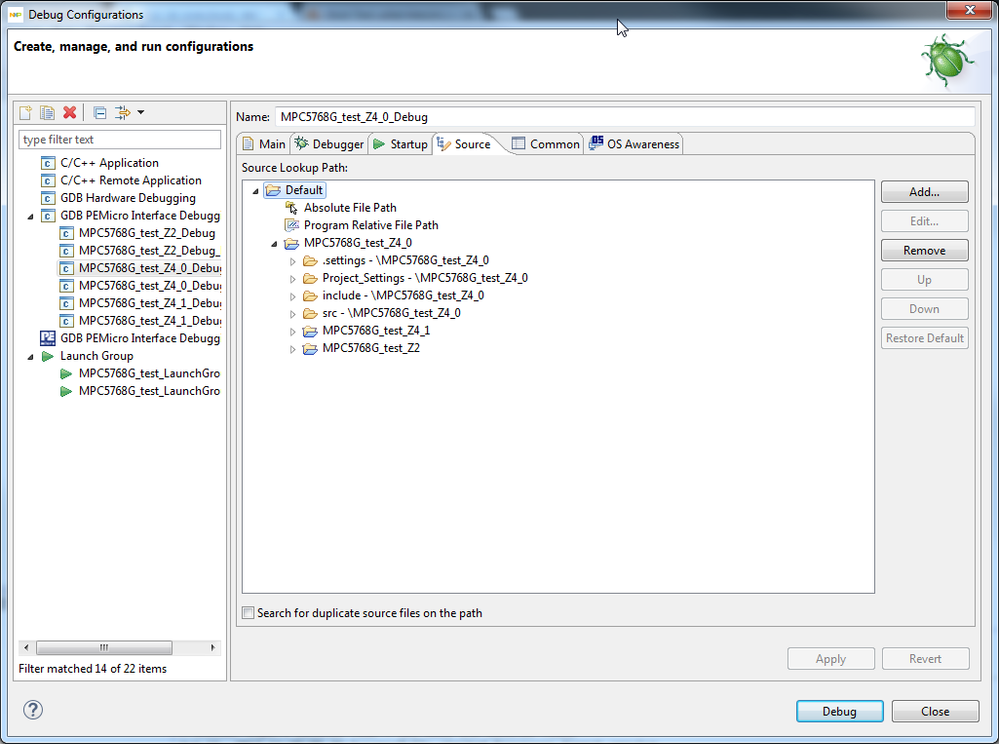

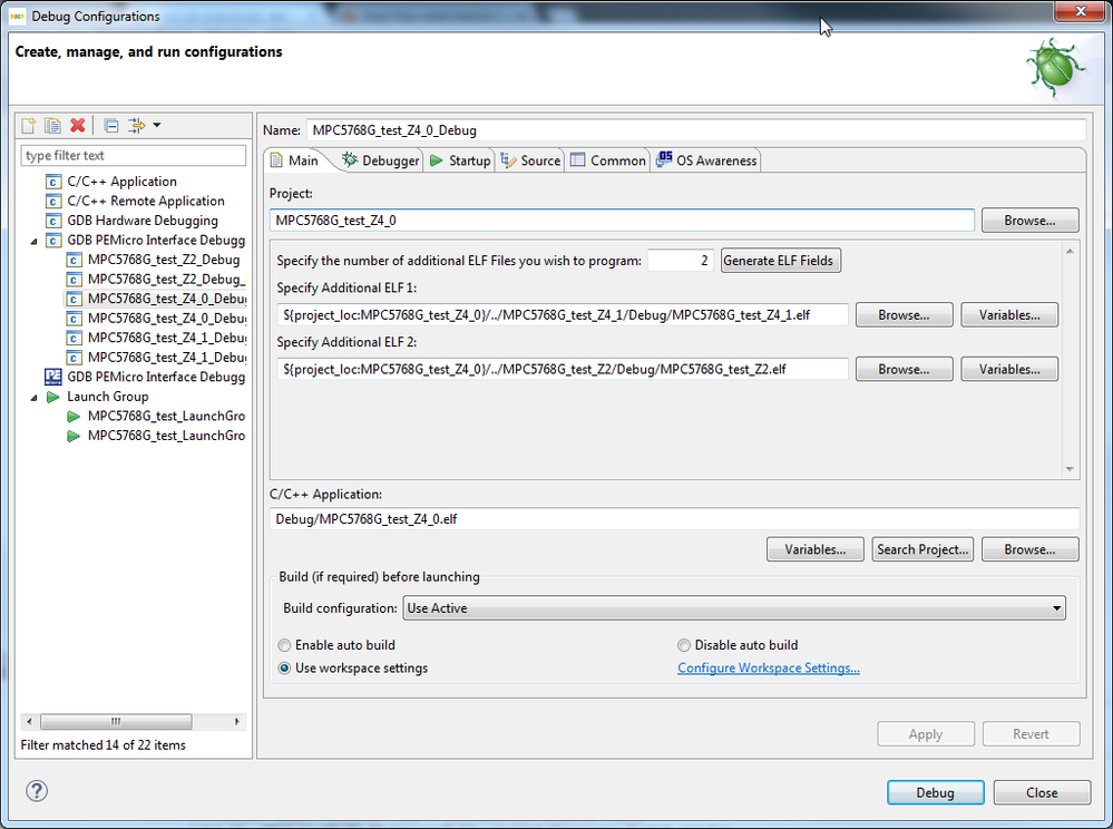

which MCU and version of S32DS you are using? Here is similar question on community. Basically you can specify multiple .elf files (for symbols) in debug confituration:
In Source tab you can setup paths for source and include directories:
In default debug configuration program stops on break point in the main() function. If you need to debug for example startup code or any other pre-main code - you need to add break point manually.

I think the example you gave in your answer will work only in the case of debugging 1 image per core, where we can use the launch group to get each core to run a separate debug session with source level debugging.
My issue was more similar to the previous similar question where multiple images for the same core. I guess like the answer in the post pointed out, you can only either adding the bootloader elf into the application project and only debug application or the other way around, but not both at the same time.
The original goal of this question was to see if there is any way to debug both images in a single debug session with all source/symbols loaded.
