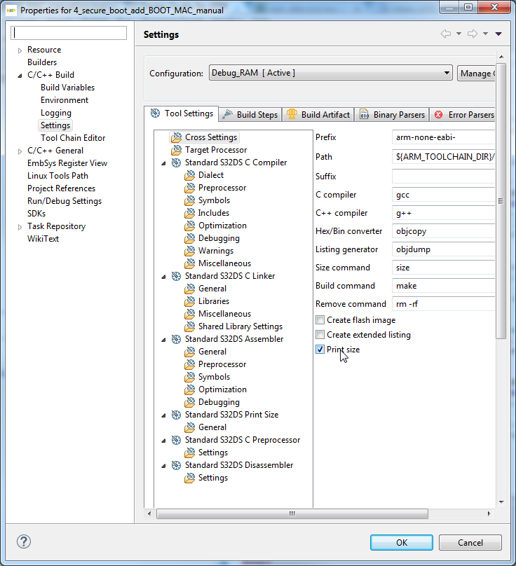

mrajanna
Contributor V
I have attached .map file for one of the application.
From .map file I extracted below information.
Memory sections
Size in bytes
.data
2436
.text
11320
.rodata
48
.bss
316
I would like to know how much RAM memory will be used when this application run on S32K144 MCU ?
Is there any provision in S32 design studio to monitor amount of RAM used when debugging this application on S32K144 evaluation board ?

jiri_kral
you can enable printing target size by right click on project name -> properties  and check the Print size checkbox
In build console you can see something like this:
Here is detailed description of each block (text, data, bss...)
Jiri

mrajanna
Contributor V
Hi Jiri,
Thank you for the information.
From your experience can you please suggest how much of RAM is required in below scenario.
Use case Scenario:
   a. freeRTOS
   b. Load secure key to CSEc + Perform encryption and decryption on plain text using loaded secure key + Prepare for       secure boot.
   c. Run OBD CAN stack
   d. Other hardware initialization if any
Mohan
6,436 Views
jiri_kral
well - I have no idea how many RAM your project will need - it depends on implementation. But I'm sure that 64kB of RAM on S32K144 is okay for your scenario.
Jiri
