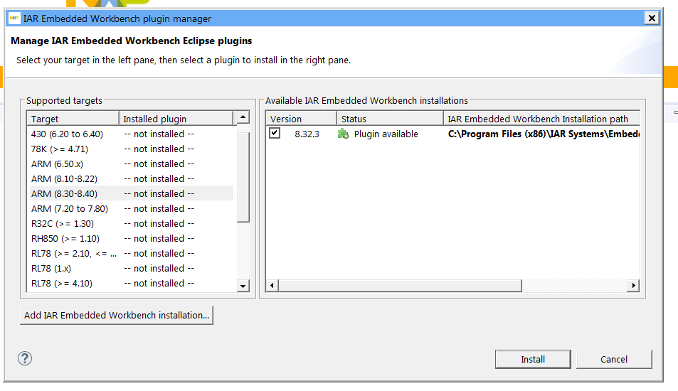

347996379
Hi, Jiri
I had the same problem.I'm also following this "HOWTO_Install_IAR_Eclipse_plugin_into_S32_Design_Studio_for_ARM.pdf"
->I run IAR plugin manager (Menu "Help" -> "IAR Embedded Workbench plugin manager...") , can show the below info.
Note: I already installed IAR workbench in my laptop, the path is C:\Program Files (x86)\IAR Systems\Embedded Workbench 8.4\,  the version is 8.42.1

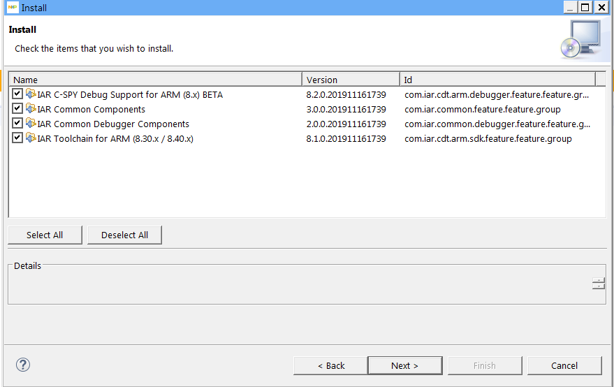

-> after click the "Install" button into next step.
-> select all, and click the "Next"  button:
-> click the "Next"  button, problem is occurred, installation failed.
  • What is the problem? Could you help me analyze the reason?

nxf58908
HI All
I tried at my end  and was able to install the plugin successfully after installing below software in Help/Install new software:
I tried with below version
IAR v 8.42
S32 DS for S32 v 3.4
Madhur

PhilChen007
Hi Jiri,
There still have issue,  kindly help you to check what caused it, Thank you.
Note: I already installed IAR workbench in my laptop, the path is C:\Program Files (x86)\IAR Systems\Embedded Workbench 8.2\,  the version is 8.32.3
