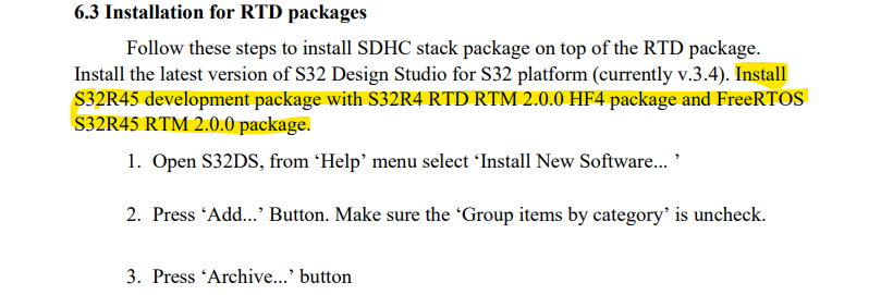

    I install the package "S32R45_SDHC_RTM_1_0_0_D2108_updatesite.zip" via S32Design Studio(Version:3.4) and i got some error:
"Cannot complete the install because one or more required items could not be found.
Software being installed: SDHC_STACK S32R45 1.0.0.202108200413 (com.nxp.SDHC_STACK.S32R45.root.1.0.0.feature.feature.group 1.0.0.202108200413)
Missing requirement: SDHC_STACK S32R45 1.0.0.202108200413 (com.nxp.SDHC_STACK.S32R45.root.1.0.0.feature.feature.group 1.0.0.202108200413) requires 'org.eclipse.equinox.p2.iu; com.nxp.FreeRTOS.S32CC.root.2.0.0.feature.feature.group 0.0.0' but it could not be found"
So how can i install the missing requirements?  Thank you!

In the release notes provided in the download site for S32R45_SDHC_RTM_1_0_0_D2108_updatesite.zip, there are some installation instructions:
Did you install all 3 packages? The errors imply that the FreeRTOS S32R45 RTM 2.0.0 package was not installed.
It is also important to note that you should install the exact version listed in the release notes or you will still receive the error. The version compatibility checker is looking for a specific version. For example, if you were to install the FreeRTOS S32R45 RTM 3.0.0 package instead of the 2.0.0, it would again fail. To overcome this, you should install the 1.0.1 version of the S32R45 SDHC RTM package instead of the 1.0.0, then the FreeRTOS 3.0.0 would be accepted.

Thank you! I install Version 1.0.1 and it works.
