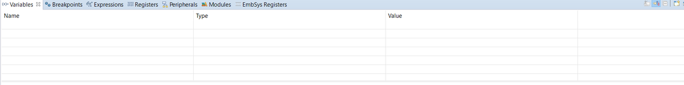

How do I monitor the variables, I can't see them

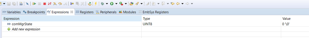

I found a "workaround" using expressions and not variables

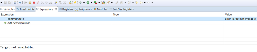

But as soon as I run my program, all values disappear

The variables view automatically shows just the local variables.
I'd recommend you to use Expressions View instead. Unfortunately this view shows the content of variables only in a debug halt.
If you want to see the variables while the target MCU is running I'd suggest you to use Real Time Expression view.
This specific view is available only for Pemicro probes (including OpenSDA).
Please check this thread:
https://community.nxp.com/message/916645#comment-916979
