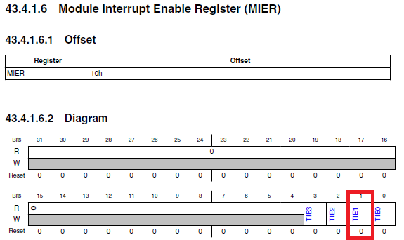

I need to configure LPIT0_CH1 in S32K144-QN57U, after some attempts I was not able to make it work, can anyone help me to review next configuration :
Thank you, Antonio.
#define LPIT0_BASE (0x40037000u)
#define LPIT0 ((LPIT_Type *)LPIT0_BASE)
void NVIC_init_IRQs (void) {
S32_NVIC->ICPR[1] = 1 << (49 % 32);
S32_NVIC->ISER[1] = 1 << (49 % 32);
S32_NVIC->IP[49] = 0xF0;
void LPIT0_init (void) {
PCC->PCCn[PCC_LPIT_INDEX] = PCC_PCCn_PCS(6);
PCC->PCCn[PCC_LPIT_INDEX] |= PCC_PCCn_CGC_MASK;
LPIT0->MCR = 0x00000001;
LPIT0->MIER = 0x00000010;
LPIT0->TMR[1].TVAL = 10000000;
LPIT0->TMR[1].TCTRL = 0x10000001;
void LPIT0_Ch1_IRQHandler (void) {
LPIT0->MSR |= LPIT_MSR_TIF1_MASK; /* Clear LPIT1 timer flag 0 */
PTD->PTOR |= 1<<LED_GREEN; /* Toggle output on port */

Hi Antonio,
From the code snippet it seems the problem seems to be caused by wrong PIT interrupt enable register (MIER):
LPIT0->MIER = 0x00000002;    // channel 1 enable (TIE1)
Hope it helps,
Stan

antonio_rodrigu
Yes, It worked.
