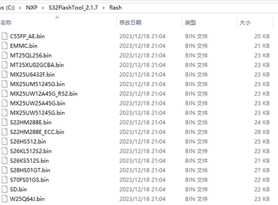

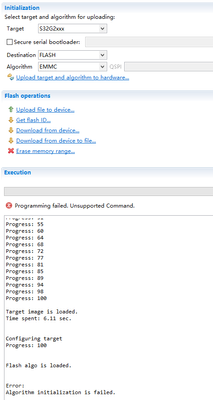

I wanted to burn the code to the emmc/flash using S32FlashTool, but I encountered the following problem:
My S32FlashTool version is 2.1.7, my board is S32G-VNP-RDB2. And I confirmed that there are relevant bin files in the installation folder of Flashtool. But why did the initialization algorithm fail?

You can try to change the switch of SW3 to OFF.

Thank you very much!
