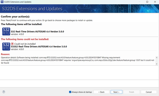

Hi S32 DS team,
I encountered this error while trying to install S32G RTD on top of S32DS 3.5 update 12 to use the DDR tool:
Install works fine on S32DS 3.6.1, but I can't use the DDR tool due to python version issue (c.f DDR test validation don't work at S32 DS 3.6 - NXP Community)
Can you help, please
Thanks in advance
K.M.A

Hi @KMA
RTD 5.0.0 are tested under S32 Design Studio update 13
Could you please install the update 13 and try again to install the RTD 5.0.0?
654件の閲覧回数
KMA
Hi Carlos, thanks for the reply,
I tested on both updates 12 and 13 and I got the same error.

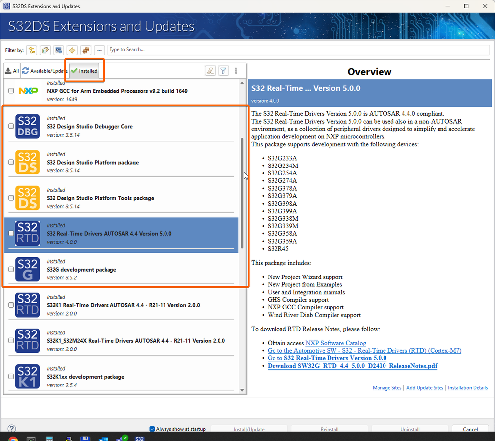

644件の閲覧回数
jiri_kral
please make sure that you have S32DS updated to latest version (v3.5.14) and installed S32G2 development package prior to install RTD v5.0.0
