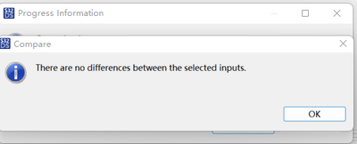

There is a pop-up window while updating code. I have to click "ok" buttion for each file.
screenshot as below
I'd like to know how to turn off this option.
Thanks!

Hi Zhend,
I believe I discovered the problem. You are using S32 Design Studio for S32 Platform v3.5 and you have somehow managed to install onto it the following:
RTD S32K3XX 2.0.1.202207071057 com.nxp.RTD.S32K3XX.root.2.0.1.feature.feature.group NXP Semiconductors, Inc.
RTD S32K3XX 2.0.1 2.0.1.202207071057 com.nxp.RTD.S32K3XX.2.0.1.feature.feature.group NXP Semiconductors, Inc.
These packages do not support S32DS 3.5, they were developed for and tested to S32DS 3.4 Update 3. They are not forward compatible.
If you wish to use this RTD package, then please install it onto the S32DS v3.4. I also highly recommend that you use the S32DS Extensions and Updates menu to install as it has built-in dependency checking and would have prevented this incorrect configuration.

This is not normal behavior. There is no setting to cause this. The comparison window should only appear when a comparison is performed, not from Update Code command.
Could you please share the file '{workspace_path}\.metadata\.log'? It should contain some clues regarding what is happening.

mikedoidge
Hi Zhend,

zp001
Hi Mike,
There is another way to fix that by deleting .metadata dirctory.
