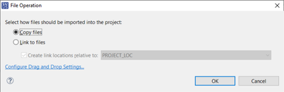

Hello:
        I found in the configuration software project that I cannot set "Properties ->Resource ->Linked Resources" in a project in S32DS, as shown in the following figure. How can I set it?
1,365 Views
mikedoidge
This page will display files which have been added to your project as a linked resource. You can set this at the time the files are added. For example, the following menu appears when you drag and drop a file into your project (Project Explorer panel):
You can see there is an option 'Link to files'. After you add the file, it will appear in the view you shared.
Mike
