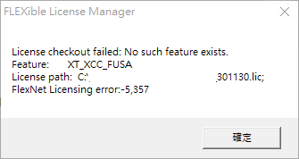

This problem occurred when i was installing BBE32 license.
When I built the BBE32 project in SW32R41_DIAGTOOL_1.0 by S32DS 3.4, the following windows would pop out.

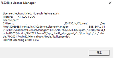

 After I selected BBE32 license got from NXP, the error still occurred.
I want to ask that what is the error-5357 meaning and how to solve this error?
Many thanks.

Hello @WuEN,
There are instructions in <S32DS Install Dir>/S32DS/help/pdf/S32R41_BBE32_DSP_User_Guide.pdf to setup the environment variables required for the tools to locate the BBE32 license. See page 10.
Mike
