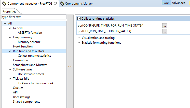

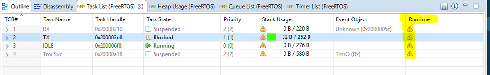

I see there is a TaskList indicator show task's information. But I cannot see RunTime view, even after check the "Collect runtime statistics". Do you know how to see the runtime statistics? Is there any special configuration to do? Thank you.

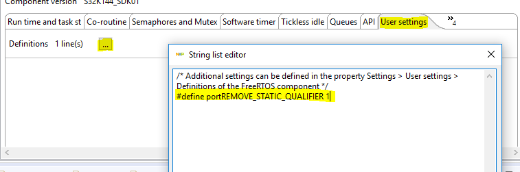

Currently I can recommend a workaround to get the Runtime facility working:
In the FreeRTOS component, go to the 'User Settings' tab and add a definition (click on the three dots):
#define portREMOVE_STATIC_QUALIFIER 1
like in this snapshot:
After, re-generate Processor Expert code.
Now the 'Runtime' facility should work as expected:
