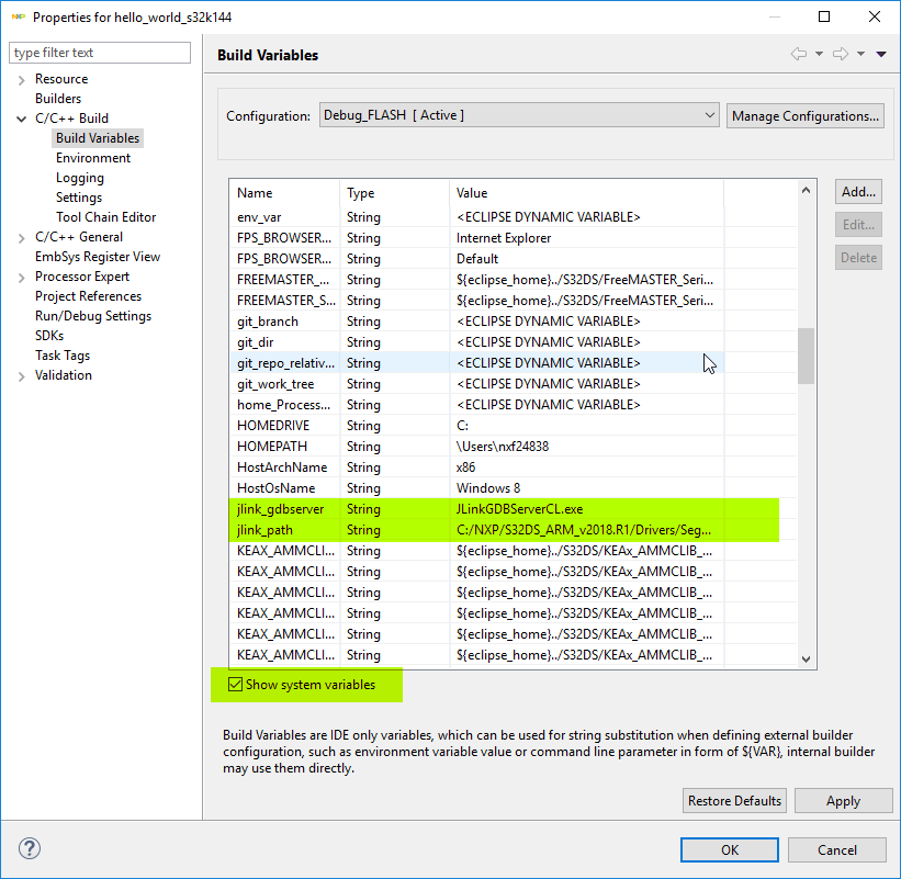

you can download latest version here - SEGGER - The Embedded Experts - Downloads - J-Link / J-Trace
Don't forget specify path in debug session for particular session:
Or you can modify environment variables:
