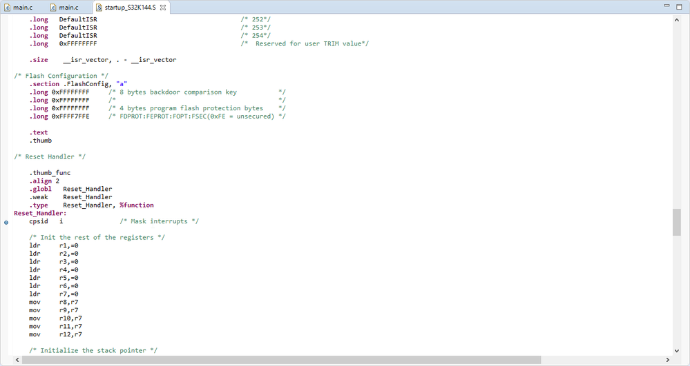

which S32DS you are using? I'm not sure what do you mean by reset point, but you can add breakpoint into reset vector handler - like this one for S32K144 in startup_S32K144.S file and continue step by step through startup:

I use S32DS for ARM.2018.R1.
When the UART transmit data, MCU is reset.
As you mention, I add break point into reset vector handler. But Any break point does not catch.
I thinks the reason of reset is watchdog timeout by interrupt.
When the UART transmit data , MCU is often reset.
I removed watchdog function.
MCU does not reset.
Blinking LED is stop.
And  A break point was caught in one of the painted parts below.
Therefore, it seems that the operation of interrupt continues to cause reset.

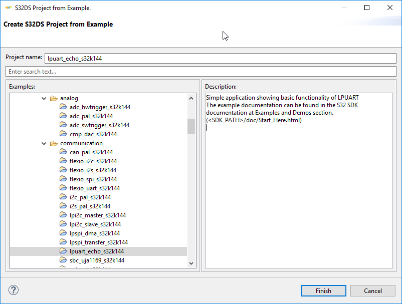

jiri_kral
So - good starting point is an example - like lpuart_echo_s32k144 (or for different MCU - I'm not sure which one you are interested in):
You can find there how to clear IRQ flag for UART and many other related stuff.

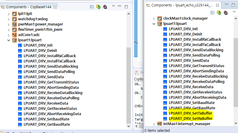

kbj
Hi Jiri,
I develop with S32K144.
I think LPUART_DRV_SetTxBuffer function is interrupt clear function.
But I don't use the function, Because I don't use S32K14x_RTM_SDK_V2.0.0.
How to import S32K14x_RTM_SDK_V2.0.0.?

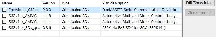

kbj
Dear Jiri,
I installed the SDK v2.0 RTM.
I can make sample code with SDK v2.0 RTM
But When I make new project, I can't select SDK v2.0 RTM.
There is not the SDK v2.0 RTM in menu.
What should I do?

jiri_kral
you need to select ARM Bare-Metal 32-bit target Binary toolchain:
