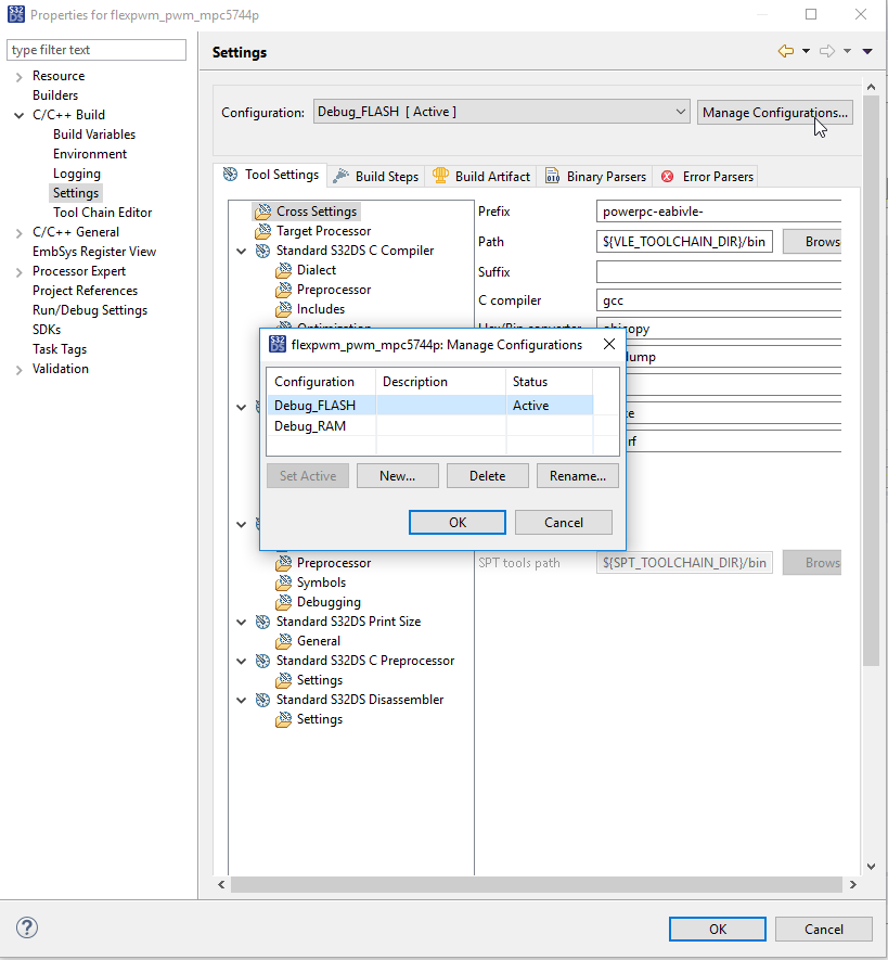

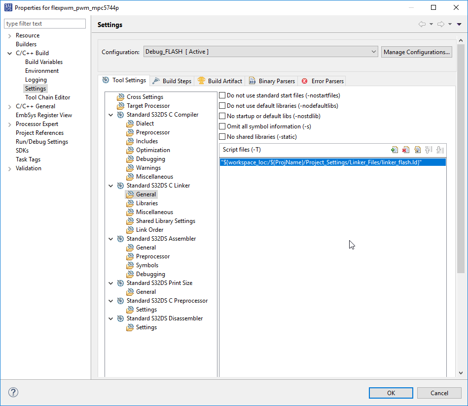

jiri_kral
you can add new configuration in configuration manager:
The difference between RAM and FLASH target is in Linker file. For your new configuration select linker script file for Flash target - pastedImage_2.png
As a reference you can look at any example - almost all of them have both configurations (FLASH,RAM).
Hope it helps.
Jiri .

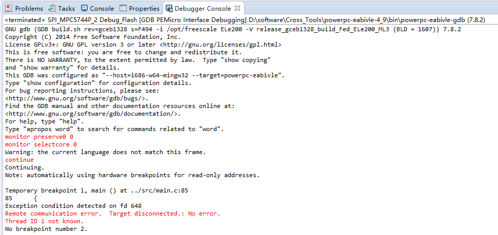

stanish
Vern,
could you please post the debugger screen that indicates the executable has not been programmed into flash.
Please also check the debugger GDB serverv console - it should include information about the programmed sections and addresses.

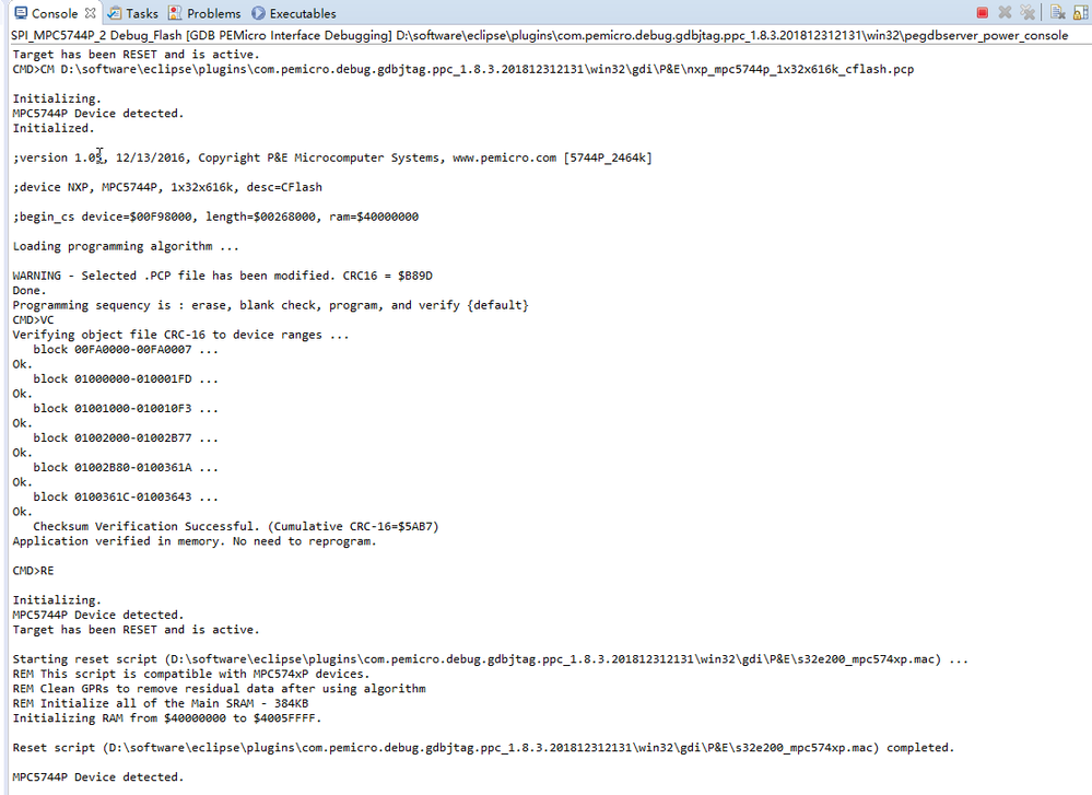

文辉王
Hello Stan,
The following is the console information:pastedImage_1.png
The following is the debugger console information:
Thanks.
8,554 Views
jiri_kral
from you screenshot it is obvious that your program is uploaded into Flash (and already present in Flash). There is probably some error in your project - it looks that you program ends in some exception. It is possible share your project?

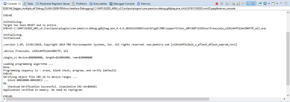

NancyW
Hello, I have the same problem, i'm trying to run an existing project on S32G3 by debugging it by using Flash. I followed the steps to add the flash linker path but I couldn't find it so I add it my self, but it don't seems to be the solution because only the RAM linker is there.
Could you help me please or tell me where to find this linker to process Flash debuging ?
