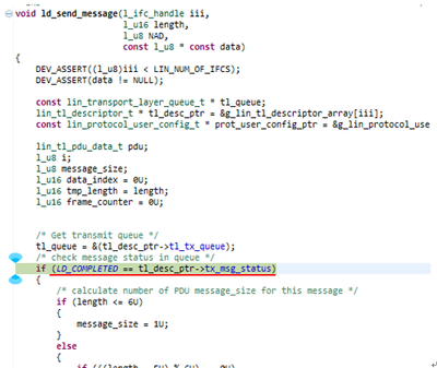

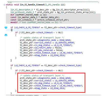

  I am working on a project on S32SDK and LIN STACK, which is adopted from lin_slave_s32k118.
And after some intentional/abnormal operations, LIN STACK fell into the below situation.
tl_desc_ptr->tx_msg_status = LD_N_AS_TIMEOUT;
tl_desc_ptr->check_timeout_type = LD_NO_CHECK_TIMEOUT;
ld_send_message() was blocked by the check statement.
Should I reset LIN STACK? and How to reset LIN STACK?
Thanks for your help a lot.
2,698 Views
RickYeh777
Just call ld_init() at the proper position.
