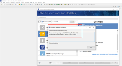

I want to install Radar Extension Package for S32DS by following these steps, but failed.
https://community.nxp.com/t5/S32-Design-Studio-Knowledge-Base/Video-Install-S32R45-Radar-Extension-P...
Radar Extension Package:
 1.1.0_D2105 S32R45 Radar Extension package 1.1.0 for S32 Design Studio 3.4
S32DS: V3.5

Hello @aiweixin,
A new version of the S32R45 Radar Extension Package has not yet been released for S32 Design Studio 3.5, please continue to use S32 Design Studio 3.4 for now.

mikedoidge
Just FYI, the S32R45 Radar Extension package 1.3.0 for S32 Design Studio 3.5 was published on 31 October 2022.

aiweixin
Hi, Mike,
I have received an email for it recently, thank you very much!
