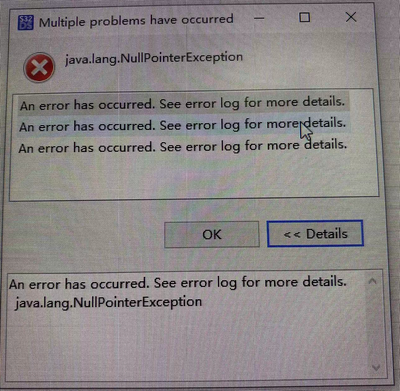

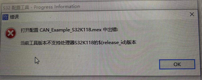

      Recently I had a requirement that I need to help someone else to setup environment for S32K116 on S32DS3.4 version on their own intranet PC,without access to the internet. I operated with the same steps just like what I did when I set up on my own computer ,which with access to the internet . but after the whole operation , I found some packages were not installed successfully, and the S32DS3.4 cannot work well, with some errors below.
then I also operate just like the below link descripts, although some missed packages installed succesfully, but the error on the 1st picture is stille exits, which poped up when I dobule clipped the S32DS CT.

Hello, please provide the installation and workspace log files.
C:\NXP\S32DS.3.4\_S32 Design Studio for S32 Platform 3.4_installation\Logs
C:\Users\<userid>\workspaceS32DS.3.4
Could you please identify which packages didn't install correctly?
All packages are available for offline install. If you will login to your account on nxp.com, then proceed all the way into your SW account where you see the page 'Product List', then click this link: https://nxp.flexnetoperations.com/control/frse/download?agree=Accept&element=12367047
You should be taken to the download page for S32DS 3.4 where you can download the following package:
Then from S32DS Extensions and Updates menu inside S32 Design Studio, you can use the 'Add Update Sites' to add the archive which was previously downloaded. Then missing packages should be available for install.

Fidel
I install K1 RTD 1.0.1 on the S32DS3.4 update3 version, and it is OK now , for the RTD 1.0.0 Version , I tried many times , all failed , so at last I give up.

mikedoidge
Hello @Fidel,
The .exe is standalone version. It can be used with any IDE.
The .zip is the S32 Design Studio integration package. It includes extra items to support the S32 Configuration Tools (Pins, Clocks, Peripherals, etc.)

mikedoidge
Hi @Fidel,
It seems I was not very clear.
The .exe file is for use when you are using any IDE (besides S32 Design Studio).
The .zip file is for use when you are using S32 Design Studio, it will not work with any other IDE. It contains everything the .exe file has plus the support for the S32 Configuration Tools and other integration support (like for new project wizard, etc.)
Of course you could try to use the .exe with S32 Design Studio, but you would have much work to do in order to make use of it as it is missing all of the integration content of the .zip file.
