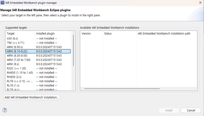

Hello, I am asking a question because I encountered a problem while installing IAR Toolchain, which is an environment suitable for S32K314.
The pages I referenced are as follows:
https://community.nxp.com/t5/S32-Design-Studio-Knowledge-Base/HOWTO-Install-IAR-Eclipse-plug-in-into...1105459
1. Install IAR Plugin manager
go to menu "Help" -> "Install New Software" and click on "Add..." button to add a new IAR repository located here: http://eclipse-update.iar.com/plugin-manager/1.0
Tick ​​" I Accept the terms of the license agreement" and click "OK" to accept unsigned content software
Finally you proceed to the installation. When the plugin is installed you will be asked to restart S32DS
Up to this point, it has been completed normally.
but
Anytime you create a new workspace you will be asked to enter path to IAR Embedded Workbench IDE
The IAR Workbench directory required by this step does not exist like this.
(No IAR System directory in Program files (x86)
Also, there is no version that can be installed from the plug-in manager.
How can I solve this problem?
2,402 Views
Julián_AragónM
Hi @malove,
The plugin only enables users to build and debug a S32DS project with IAR toolchain for ARM. In order to use the plugin, you need to have IAR Embedded Workbench installed with a valid license from IAR.
You may need to contact IAR in order to download EW: IAR Embedded Workbench for Arm | IAR.
Julián
