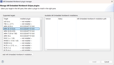

Hello, I am asking a question because I encountered a problem while installing IAR Toolchain, which is an environment suitable for S32K314.
The pages I referenced are as follows:
https://community.nxp.com/t5/S32-Design-Studio-Knowledge-Base/HOWTO-Install-IAR-Eclipse-plug-in-into...1105459
1. Install IAR Plugin manager
go to menu "Help" -> "Install New Software" and click on "Add..." button to add a new IAR repository located here: http://eclipse-update.iar.com/plugin-manager/1.0
Tick ​​" I Accept the terms of the license agreement" and click "OK" to accept unsigned content software
Finally you proceed to the installation. When the plugin is installed you will be asked to restart S32DS
Up to this point, it has been completed normally.
but
Anytime you create a new workspace you will be asked to enter path to IAR Embedded Workbench IDE
The IAR Workbench directory required by this step does not exist like this.
(No IAR System directory in Program files (x86)
Also, there is no version that can be installed from the plug-in manager.
How can I solve this problem?

Hi @malove,
The plugin only enables users to build and debug a S32DS project with IAR toolchain for ARM. In order to use the plugin, you need to have IAR Embedded Workbench installed with a valid license from IAR.
You may need to contact IAR in order to download EW: IAR Embedded Workbench for Arm | IAR.

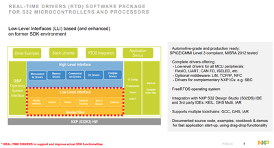

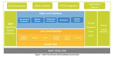

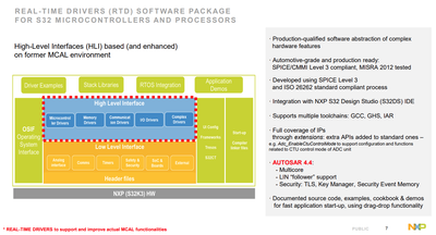

It means, If I select the RTD SDK(PlatformSDK_S32K3), Can I use this RTD for non-AutoSAR projects? or Only use for AutoSAR project?
4,132件の閲覧回数
Julián_AragónM
Hi @malove,
Yes, even if you use RTD, you can still develop non-AUTOSAR applications. The high-level interface drivers are based on MCAL, and low-level are based on former SDK. You can use low-level drivers for non-AUTOSAR:
You can refer to the following training presentation for a full overview of the differences: 02: S32K3xx Real-Time Drivers (RTD) Installation Guide - Training (nxp.com).
I hope you find this helpful.
Julián

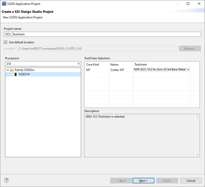

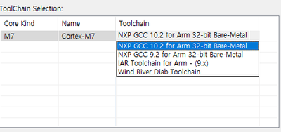

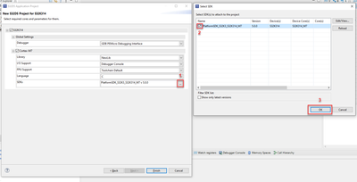

malove
Thanks @Julián_AragónM
Is there a way to use GCC as the toolchain for the S32K314?
As shown in the picture, when I select IAR as the toolchain for S32K314, the SDK is selected, but when I choose GCC, the SDK isn't selected, so I am asking about this.
4,231件の閲覧回数
Julián_AragónM
Hi @malove,
Yes, you can select GCC for S32K314:
Make sure to have correctly installed the RTD package you need to use, or else, no SDK will show when trying to attach.
Julián
