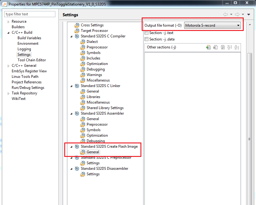

vladstoica
How can I generate a srec file with s32 design studio, it's generating an .elf file by default, but how can I make a srec one? An also how can I see the data of that srec file so I can make an array with that data for simulation.

martin_kovar
Hi Vlad,
open project settings and in Cross Settings check Create flash image. Click OK. Open project setting again a check if there is Motorola S-record chosen in Standard S32DS Create Flash Image/General.
Recompile the project. Srecord is generated to folder debug or release according to compiling option. It is text file, so you can open it directly in S32 or you can you any text reader.
Martin
