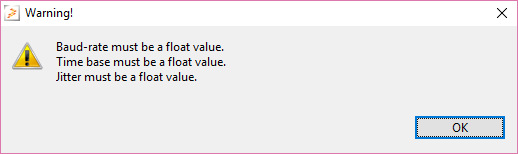

I'm not sure whether this is the right forum. However I'have the following problem with the Eclipse Plugin of the Freescale LIN Driver (I'm using FSL_LIN_2.x_STACK_4.5.4.exe):
If I open a previously saved LDF file and change from GUI editor to Text editor tab, I'm getting this message:

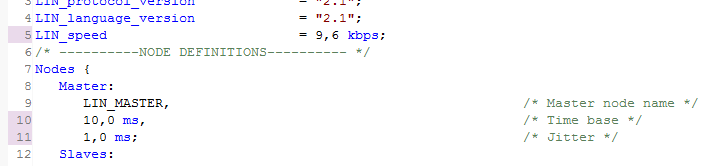

But if I change from GUI editor to Text editor, the tool changes the dots of the float numbers into commas:
LIN_speed                        = 9,6 kbps; /* ----------NODE DEFINITIONS---------- */ Nodes {    Master:       LIN_MASTER,                                            /* Master node name */       10,0 ms,                                               /* Time base */       1,0 ms;                                                /* Jitter */
If I would save the modified file (with commas), the tool can't open it again.
This all might be to do that I'm running this on a Windows with german language settings, however for me it seems to be a very annoying bug.

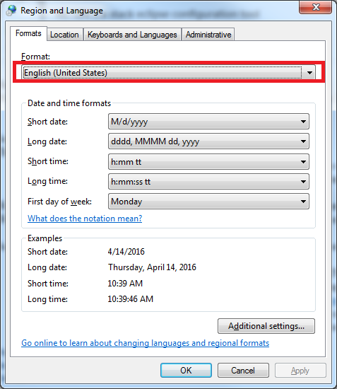

We suggest to try one of workaround solutions:
Option 1.  Change Windows format language to English

stanish
I've just tested this plugin with S32DS for Arm v1.1 and I cannot reproduce the issue you describe on my side. (English version of OS) I suspect this is rather OS related issue. Which OS do you use?
Could you check your Region and Language settings in Control Panel (If you are using it under Windows OS)

0815
I'm using S32 Design Studio for ARM v1.0 build 150626 right now, but experienced this issue also with earlier versions of KDS.
Steps to reproduce this are very simple:
  • Open the LDF, it will be shown in Text editor by default.
  • Switch to GUI editor tab.
  • Switch back again to Text editor tab. In this moment the above shown warning comes up. At the same time changes will be done automatically in the Text editor as mentioned before:
