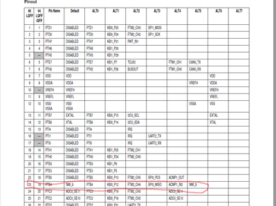

I need example software for How to configure NMI in S32KEA128, the microcontroller straightly restarts when it reaches the instruction that does either the NMI interrupt enable or the pin mux configuration. I've tried many things but I get always the same result.

I suppose that you use S9KEA128 instead of S32Kea128.

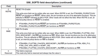

For the S9KEA128, the PTB4 is the NMI pin. while You have to set the
SIM_SOPT0[NMIE] bit.

i tried the below code but its not working, the register NMIE bit is not updated even after updating it, i gave a breakpoint and tested it, kindly clarify (Note: i used S9KEA128AML )
gpio_port_b_input_init(pin_4);
SIM->SOPT0 |= SIM_SOPT0_NMIE_MASK; // Set the NMI enable bit
NVIC_EnableIRQ(NonMaskableInt_IRQn); // Enable NMI in the NVIC

Pls try to just use the code:
//gpio_port_b_input_init(pin_4);

It appears that you do not need do anything, just connect the PTB4 to a low voltage, the ISR of NMI will be entered.
Pls check the ticket
https://community.nxp.com/t5/Kinetis-Microcontrollers/KEAZN16-NMI-problem-at-startup/m-p/599475
