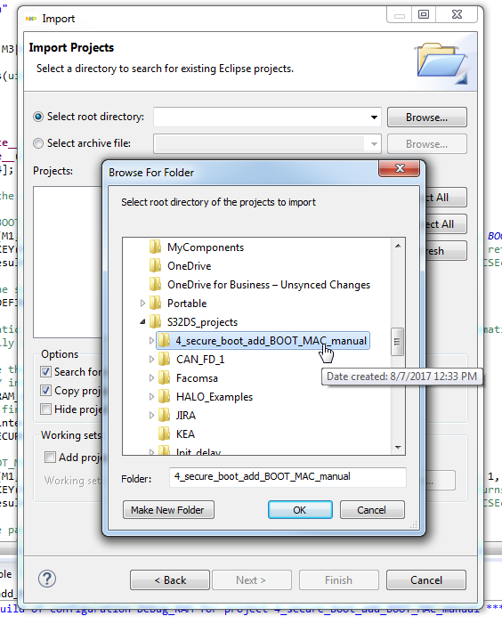

How do I compile these source code one by one in S32 Design studio ?
I am particular about compiling '4_secure_boot_add_BOOT_MAC_manual' in S32 Design studio environment.

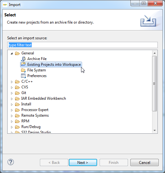

Start S32DS for ARM, on the main menu bar click on File -> Import...
On the import window select General -> Existing project into Workspace
and select project which you are interested in
Now you can build it and upload into EVB for testing.
Jiri
