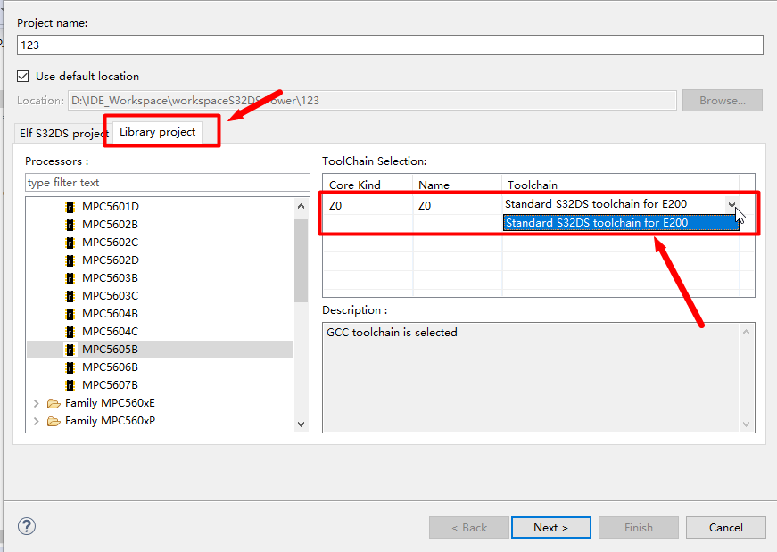

BUT When I want to compile a library file,I can not choose the GHS toolchain:
How do I use GHS Toolchain to build the library files(*.a file)  ??

Thank you fro the report!
This is a known issue in S32ds ARM v1.3. This should be fixed in the next S32DS release.
Stan

stanish
This is a known issue in S32DS Power as well. This should be fixed in the next release/update.
Regarding GHS plugin: S-record generation could be setup in Project properties -> C\C++ Build -> Settings:
Hope it helps.
