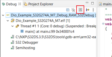

Hi team,
I saw there is an article in the community knowledge base, by @stanish. very nice.
https://community.nxp.com/t5/S32-Design-Studio-Knowledge-Base/HOWTO-Reset-MCU-in-S32-Design-Studio-d...
I followed the guide and found the reset button is active by using the PE debugger.
But when I use S32 Debug Probe
https://www.nxp.com/design/design-center/software/automotive-software-and-tools/s32-debug-probe:S32-...
that reset icon is always inactive when I debugging the code, do you know can S32 Debug Probe support reset?
1 解答
10,477 次查看
stanish
I did some investigation and unfortuntely there is no easy way how to perform in-target reset by debugger using S32 Debug Probe. Especially in multi-core debug environment.
It is recommended to restart debug session instead of resetting the target.
See attached the list of known limitations related to scripting.
Hope it helps.
Stan
