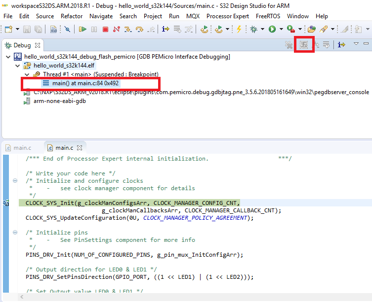

Reset button icon is active only in the active debug session (debug perspective) and in the root debug context only.
By default the reset icon is inactive during project debugging:
To activate the reset icon change the Debug view context to the root one.
After reset is completed the execution stops at the application reset vector and the information about reset that has just occurred is displayed in GDB server console.

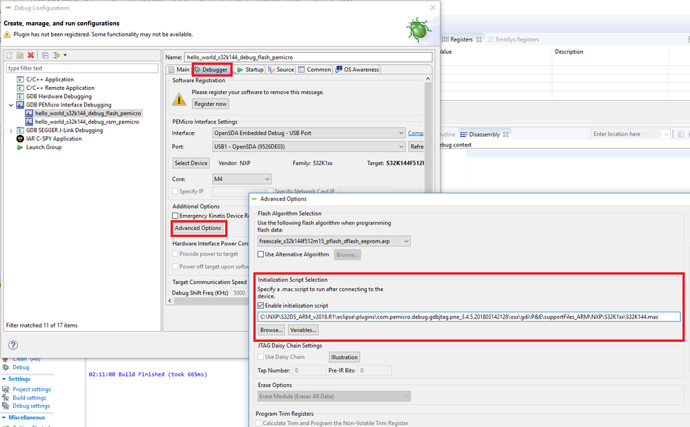

It is also possible to execute initialization script (.mac) which is triggered by the reset action. The reset script can be selected in the  Debug Configuration (Debugger Tab -> Advanced Options -> Enable Initialization Script)
