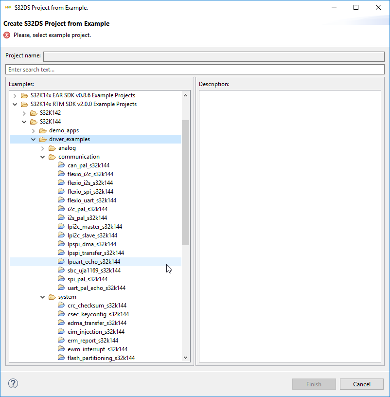

I looked at you project and question is - how do you find out that UART doesn't work? In your project is only UART init function - returning STATUS_SUCCESS.
Please look at lpuart_echo_s32k144 example for reference:

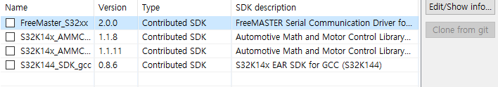

1. How to get the S32K14x_RTM_SDK_V2.0.0?

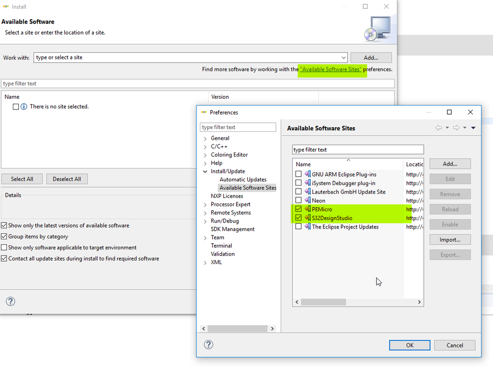

You can click on this message box - probably appeared after S32DS Launch to update S32DS:

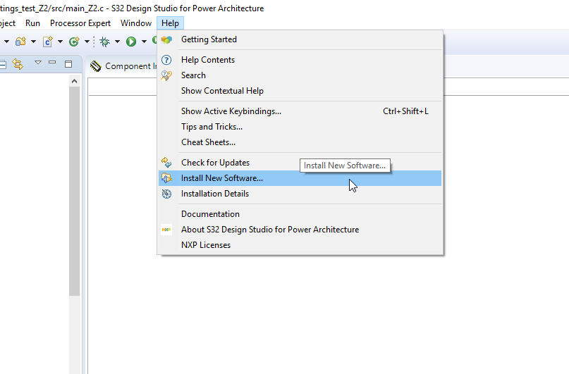

If you don't see such message - update your S32DS Installation manually  - on main menu bar click on Help -> Install new software

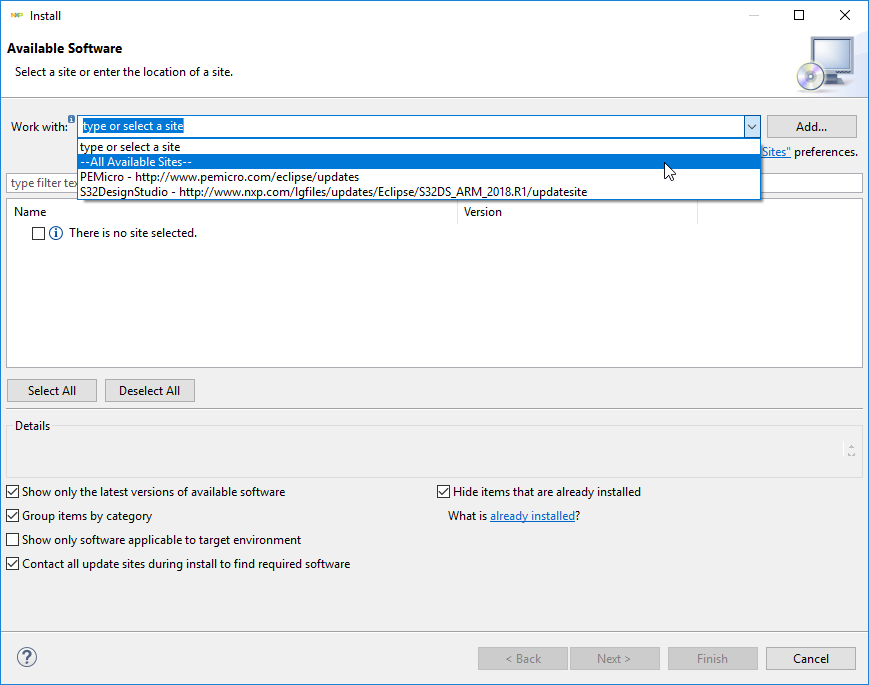

Click on available sites, choose PEMicro and S32DesignStudio, click on OK
In Work with row select All Available sites - and when updates will be found - click on next.
As I mentioned above - best starting point is LPUART echo example - this example is available in any SDK version and uses interrupts.
Hope it helps

1. How to import S32K14x_RTM_SDK_V2.0.0?
    I get the samplecode with S32K14x_RTM_SDK_V2.0.0.
    But I don't use S32K14x_RTM_SDK_V2.0.0.
    So I don't use some funtions.
