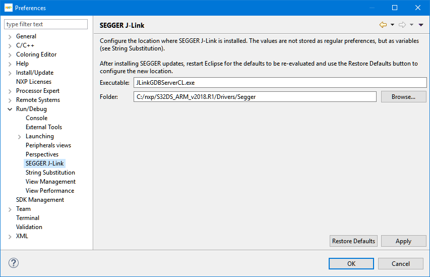

Anyone know how to specify j-link path fo S32DS? i have updated the latest j-link driver, dont' know how to specify j-link path, S32DS use old j-link path under S32 folder.

It is in the workspace preferences:
I hope this helps,
Erich
