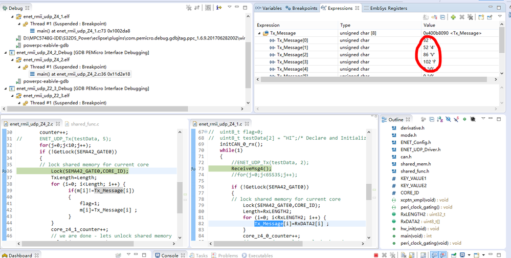

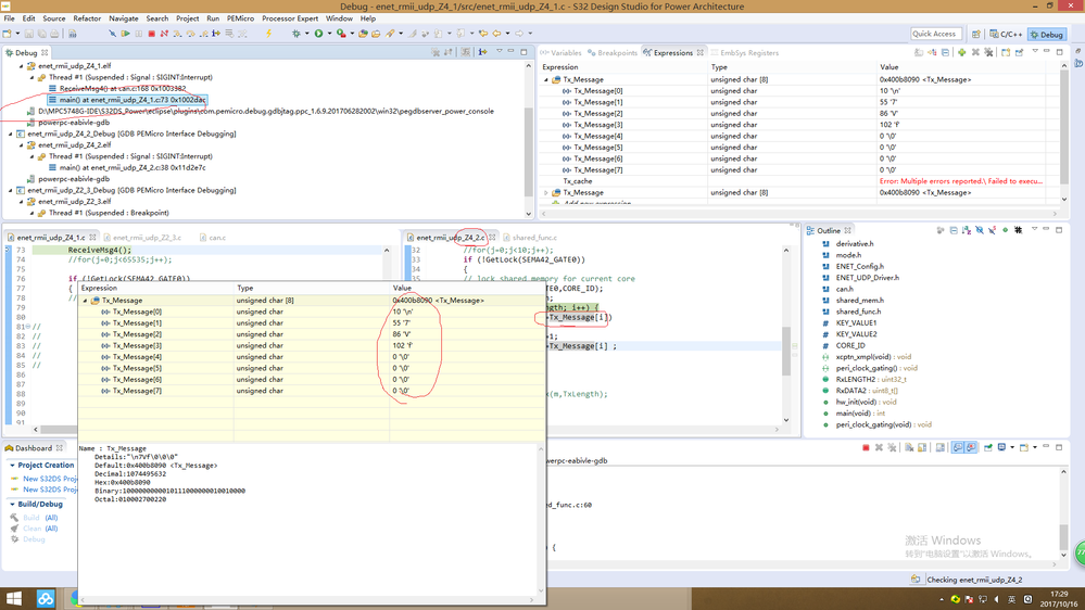

I want to use core0 to receive some CAN data,and then transmit these data to the terminal by using core1.So i write some code in these two sub-project,how can i transmit  the data which i received in project Z4_1 in project Z4_2?201439_201439.PNG捕获.PNG

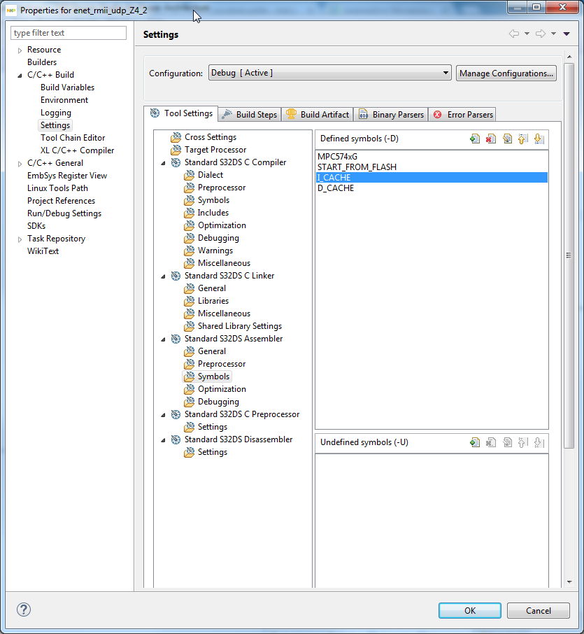

this is really strange. But technically - there is only one Tx_Message instance on address 0x400B8090 - as you can see in your debug window. I can't reproduce it with test data. You have enabled I_CAHE and D_CACHE for Z4_2 core - try to remove these defines from your project settings for test:
I also can't see any difference on screenshots - may be I don't get the correct order. there are the very same data on picture #1 and #2 and different same data on #3 and #4.

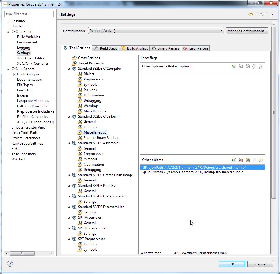

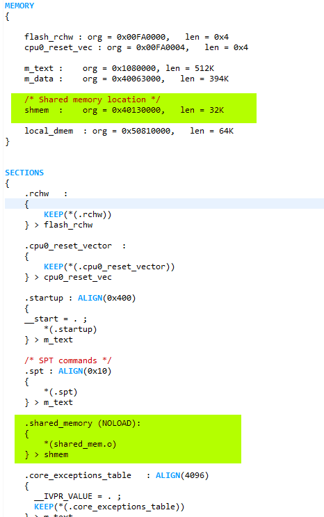

you also need to modify linker files for all cores. Please check the linker files in the example and  your project (Your Project Name->Project_settings->Linker_files). You need to add path for shared objects (shared_mem.o and shared_func.o) into project settings (see screenshot bellow). Source codes - shared_mem.c and shared_func.c needs to be build by the firstly built core project (one of the cores is always build as the first and I can't find way how to change the build sequence - looks like that it is alphabetically sorted).
The basic idea is
  •  one memory space and starting address shared across cores (one instance for all cores) - technically linked shared_mem.o object on the very same address for each core
  • usage semaphores for accessing shared memory  (one instance per core) - technically linked shared_func.o on unique address for each core.
Here is linker file with added shared mem location:

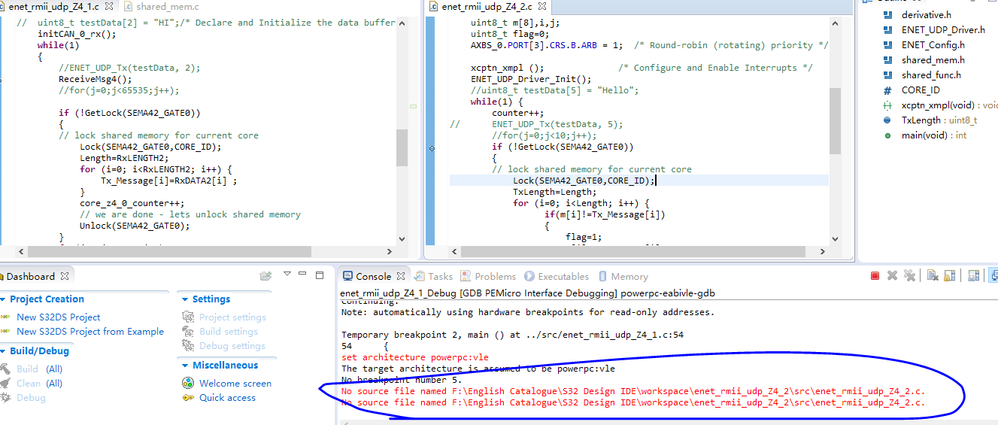

I still have a question that when i import a project,in debug process,if i want to set a breakpoint in Z4_2 project,it always can not be effective,and the console window shows these messages:捕获.PNG
And the breakpoint in Z4_1 project is effective.

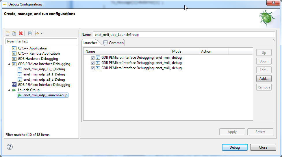

jiri_kral
I have no issue about sources. Did you start debug session as a launch group?
Your issue also may be caused by spaces in the path - like "S32 Design IDE". You can try to locate your workspace in the path without spaces.

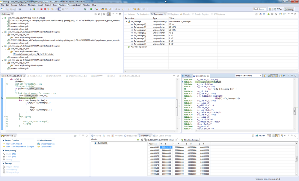

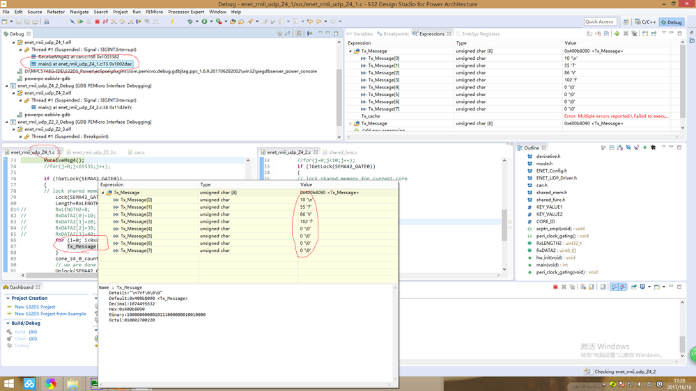

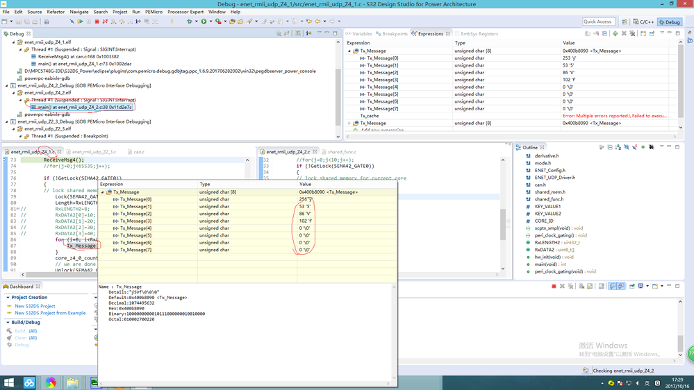

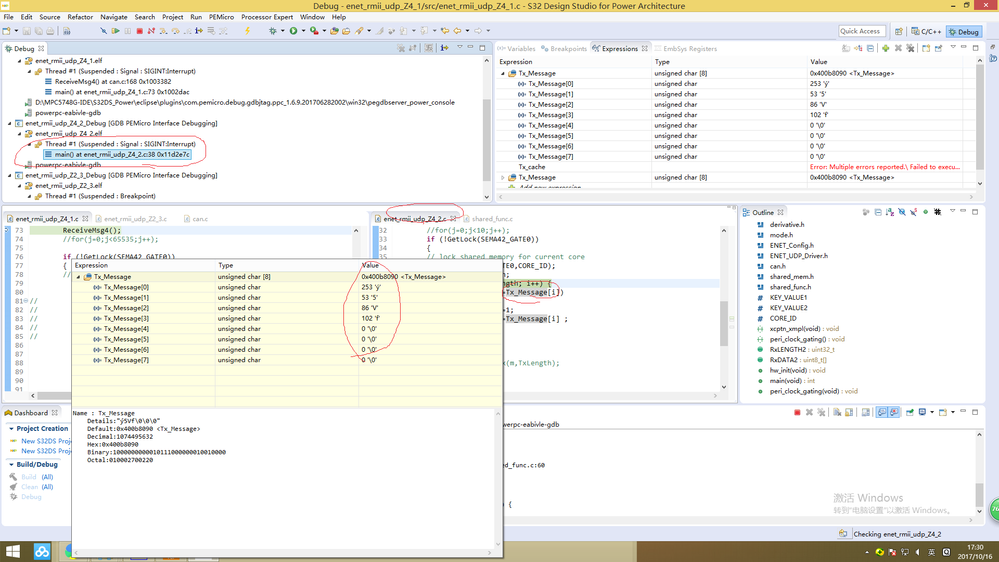

timwang
Hi Jiri,

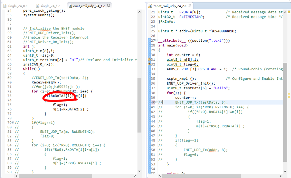

Actually,in core0 ,i keep receiving data from CAN_0,and store the data in Tx_Message.In core1,i read the data in Tx_Message and transimit them by ENET.
My problem is that in core1,only the first data in Tx_Message can be read normally.When the data that core0 received changed,Tx_Message should also change.But in Z4_2 project,the Tx_Message didn't change.
For example,the data that core0 recevied first are{253,53,86,102},then the data changed to {10,55,86,102},the Tx_Message shoule change to{10,55,86,102}.But on debugging,if i choose the Z4_1 debug,the Tx_Message are{10,55,86,102}, if i choose the Z4_2 debug,the Tx_Message are still{253,53,86,102}.

jiri_kral
Jiri
9,673 Views
timwang
Hi Jiri,
Thank you very much!
Disabling I_CAHE and D_CACHE for Z4_2 core works for me!

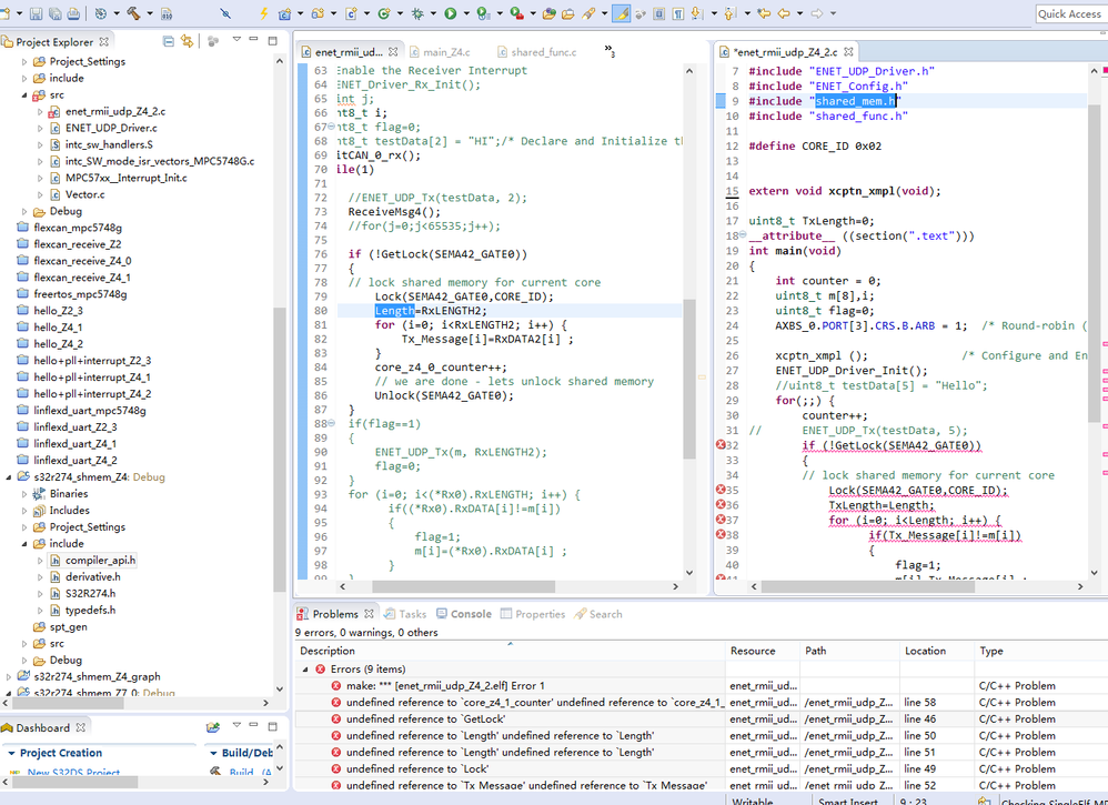

I have added these two files shared_mem and shared_func into my project.But i still have thses faults,do i have to make some other configuration?捕获.PNG
