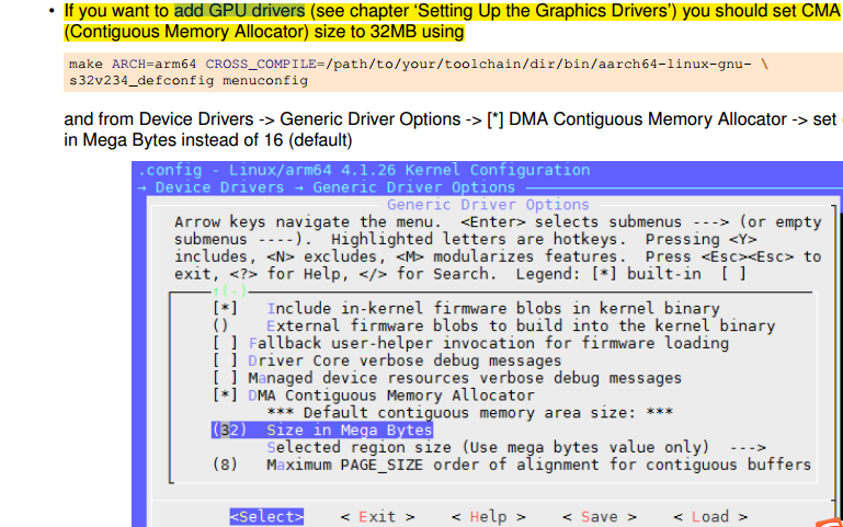

Hi,expert
    I have a s32v234evb28899 borad in my commpany, and I found that I could use Linux BSP17.0 with the VSDK1.1.1。I used the uboot and linux Image created by the Linux BSP17.0(add patch from VSDK1.1.1)  as uboot and lmage. And I used the dtb and rootfs.tar.gz from VSDK1.1.1 's build_content 'v234_linux_build'. It worked well and I could use the demo elf from the vsdk.
   Unfortunately, I followed the user manual of Auto BSP17.0 to add GPU drivers. It caused that the VSDK drived modules failed to insmod. I just changed the menuconfig and setted CMA size to 32MB as below.
     Then the error log was:

[   16.007162] loading NXP PHY driver: [autonomous mode]
Auto Linux BSP 1.0 s32v234evb /dev/ttyLF0
s32v234evb login: [   55.412757] random: nonblocking pool is initialized
s32v234evb login: root
root@s32v234evb:~# cd /s32v234/
root@s32v234evb:/s32v234# ls
apex.ko  cam.ko  csi.ko  fdma.ko  galcore.ko  h264dcd.ko  h264enc.ko  jpegdcd.ko  oal_cma.ko  seq.ko  sm_drv.ko  viulite.ko
root@s32v234evb:/s32v234# insmod apex.ko

5,262件の閲覧回数
nxa13002
Did you rebuild VSDK drivers ? . You need to rebuild VSDK drivers after you build Image and dtb
10 返答(返信)
5,262件の閲覧回数
nxa13002
Hi ,
I have tried with bsp18_rc7 using following steps:
- make ARCH=arm64 CROSS_COMPILE=aarch64-linux-gnu- s32v234_defconfig
- make ARCH=arm64 CROSS_COMPILE=aarch64-linux-gnu- menuconfig
then follow GPU enable instruction above.
Apply Patch from VSDK
- patch -p1 -i $(SDK_ROOT)/os/linux/0001-s32v234-dts-Add-VSDK-specific-configuration.patch
Then build vsdk drivers and galcore driver. It can insmod all vsdk drivers and galcore driver
5,262件の閲覧回数
zhangweikanghus
Thank you. Can you tell me how can I get bsp18_rc7? I just found bsp17_hf1 in the NXP.com.
5,262件の閲覧回数
nxa13002
To get bsp_18 rc7 do following steps:
  - Go linux repo
 - git fetch
- git checkout [tag_bsp18]
But I think that you can insmod galcore with bsp17 with the steps:
And make sure that you have to build again all vsdk drivers and galcore driver
5,262件の閲覧回数
zhangweikanghus
   Thank you. Is Your VSDK version  RTM1.2.0 ?
5,262件の閲覧回数
nxa13002
Yes, But I am not sure that BSP which is included in VSDK 1.2 that the CMA is enabled or not
5,262件の閲覧回数
zhangweikanghus
Thank you.
You use galcore.ko built by yourself with the VSDK1.2's Image & dtb & rootfs,and it works successfully?
Does it work successfully with the Image built by BSP18.0?
5,262件の閲覧回数
nxa13002
No, I did not use Image and dtb from VSDK1.2 , I built Image and dtb by myself . The Image and dtb from VSDK1.2 did not enable CMA configure .
5,262件の閲覧回数
zhangweikanghus
Can you show your boot log? I built Image in Yocto and enable CMA configure.Then the kernel module in VSDK‘’s rootfs such as apex.ko cannot insmod.
  The error log is:[ 5.415362] apex: loading out-of-tree module taints kernel.

[ 5.468928] Internal error: Oops: 96000006 [#1] SMP
[ 5.473765] Modules linked in: apex(O+)
[ 5.477583] CPU: 3 PID: 689 Comm: insmod Tainted: G O 4.14.34-rt27+g5b7d979 #2
[ 5.485892] Hardware name: Freescale S32V234 (DT)
[ 5.490570] task: ffffffc0469a4280 task.stack: ffffff8009c68000
[ 5.496469] PC is at apex_probe+0x24/0x3d8 [apex]
[ 5.501143] LR is at apex_probe+0x24/0x3d8 [apex]
[ 5.505814] pc : [<ffffff80005f02b4>] lr : [<ffffff80005f02b4>] pstate: 20000145
5,263件の閲覧回数
nxa13002
5,262件の閲覧回数
zhangweikanghus
Thank you I didn't rebuild it. I will try it soon.
