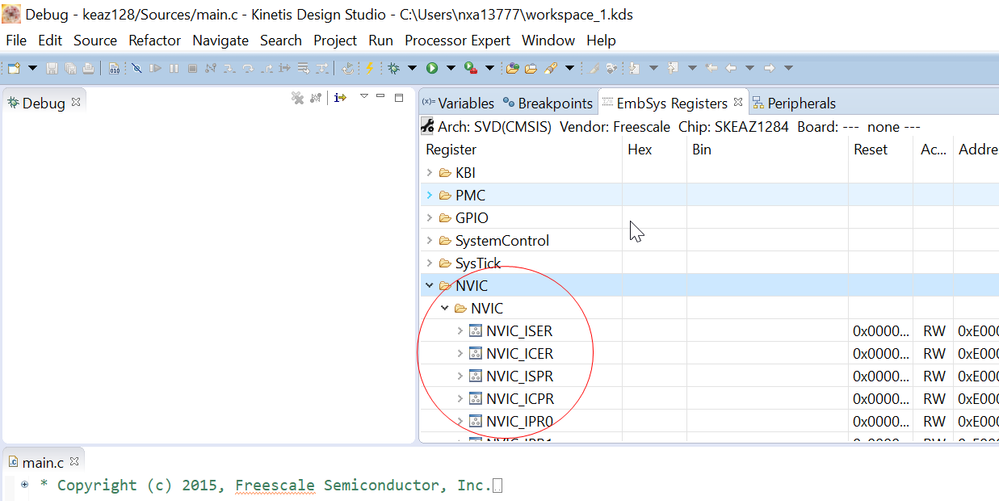

Hello Liu,
It seems the EmbSysReg view on S32DS doesn't support core registers , KDS can view them :
I will report it to development team.
Hope it helps,
TIC
