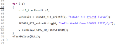

3. In S32DS Debug with SWD and I called this function "SEGGER_RTT_Init" before I used "SEGGER_RTT_printf "

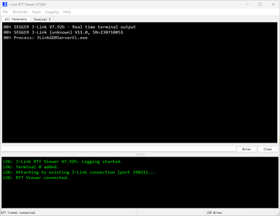

4. My RTT Viewer can connect to the hardware  correctly, but without any output,

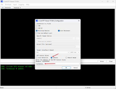

_SEGGER_RTT, Find the address of the variable in map, and config it in RTT viewer.

I'll show you my actions to help more people view this issue.
1.find .map file
2. Please pay attention to this when connecting your device
3. thanks again.
