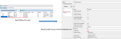

When you change Pin-Tool, it hasn't changed the generation files yet. You must add the Pin you change into Port module of Configurations tool also:
Then, when click on Update Code, it will update generated file.
Pin-Tool is where you can confige attribute for the specific pin, and to use this pin, you need to add it in Port module.

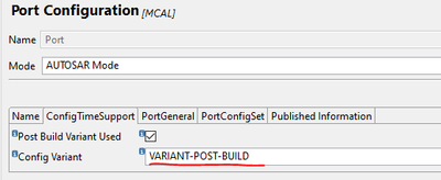

The meaning of PB is Post-Build, which is related to the Config Variant type you use to generate these config module.
- If use Post-build variant: You must call Port_Init(&Port_Config);
- If use pre-Compile variant: You must call Port_Init(NULL);
