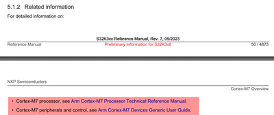

lukaszadrapa
Hi @JasonChou
it's core registers, so it's described in the core manuals:
http://infocenter.arm.com/help/index.jsp?topic=/com.arm.doc.ddi0489d/index.html
http://infocenter.arm.com/help/index.jsp?topic=/com.arm.doc.dui0646b/index.html
hseSmrEntry_t (your SmrEntry[4]) has more items which I can't see in the code. You can find details in API RM. Could you check how those items are initialized?
